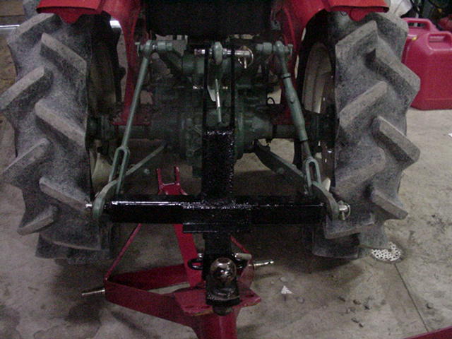

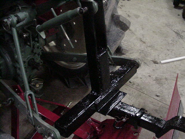

I had an old hitch from a junk truck that I was able to cut up, add pins, etc. Made a great little 3PH for moving trailes around the yard, stuff like that. I wouldn't trust my welding to go driving down the road with it though, might get a little too exciting for me /forums/images/graemlins/blush.gif
I only had about 5-10 bucks (and a little time) in the whole thing, but I already had the hitch from the truck to use. Maybe you could find a used hitch in the junk yard to do something like I did? Not sure how much they charge for something like that.

Oops, forgot I had a picture.... Don't make fun of my welding skills /forums/images/graemlins/smile.gif So far it has held together. I added the two pins for the lift arms and the two metal bars that go up to the top link. I think I used something I found off the shelf at TSC that already had the holes, so I didn't have to drill them. The rest was from the old truck hitch. Oh, and some old black spray paint I had on the shelf (everybody has at least two cans of partially used spray paint), helps slow down the rust, makes it not quite as ugly /forums/images/graemlins/smile.gif
I've seen ones like this for $150-$200 before. Of course they were prettier than mine but who cares /forums/images/graemlins/grin.gif

Another shot...
