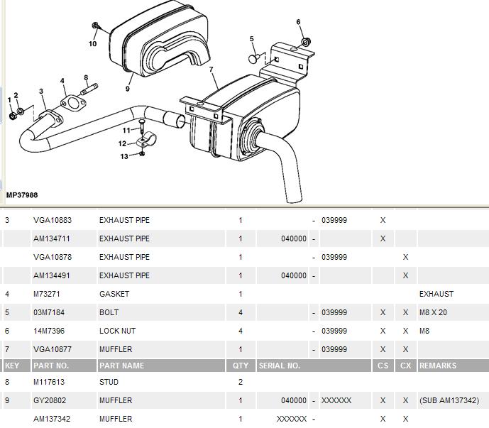

I looked at it more and used the good old engine stehetscope, but it looks like the noise is actually the buffer or inside the muffler or how the pipe goes into it. I think my plan is to take the muffer and pipe off and check out what I can see inside, I can't imagine such a new machine has a bad muffler, but the noise isnt right. When you give it quick throttle or reach a certain rpm something starts vibrating, an it sounds bad. any other ideas?

Try high temp silicone sealant on the joint. It's good for 350 degrees of heat. Maybe it just a leak between the pipes causing the squeak.

I guess I was on the right track. I used a product that I have had for a long time called chamber seal, designed for gap sealing for exhaust manifolds. I sanded the rust off the pipe and inlet, cleaned it, and applied this stuff, its sort of like two sided tape but claims it works. Its too late to take it out, but I will post my results in the am, I really hope thats all it is.

Hope that works for you.
Looked up the muffler, and there are two depending on the s/n

Not 100% sure, but just went out for a spin and it sounds quieter and I don't hear any noises any longer. I really appreciate that pic, I am going to look at a new one at the dealer, I think that they must have changed the design. There is no good way a simple slip exhaust could hold up, it needs some type of seal. The cost of a new pipe and muffler is crazy so I think that if my sealant doesn't hold up, I will weld the pipe in the muffler, and to aid later dissasembly I will cut the pipe itself and add a pipe with a slit and a clamp. Glad it wasn't the tranny which was my worry.
   / Chatter/Squeak from Gator CX
That definitely was it, not a good design at all must be why they changed it, my space age putty seems to be holding so I will leave it for now but will weld it and do some stuff it it breaks again. thanks for the help and pics!
