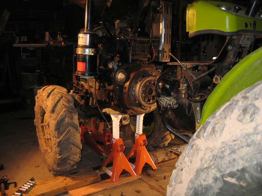

Yanmar experts/enthusiasts,
Several months ago I had a whirring/chatter noise coming from the clutch area of my YM155D (720hrs on meter but could well be more). It would occasionally chatter when idling in neutral and I was off the tractor (clutch pedal up). The noise went away when I depressed the clutch. Since then I split the tractor and replaced the friction disc, pressure plate, splined shaft, throw-out bearing and pilot bushing. Problem solved... at least until now. It recently started chattering again after only 15 hours since the new bearings/bushing. What gives? Has anyone else had this problem? I can't believe the pilot bushing would be worn already. The chatter/clatter is intermittant and goes away after the tractor is warmed up after a half hour or so.
If it's an option on this forum, I'll post a short mp3 audio file so you can hear the noise.
Thanks for your help.

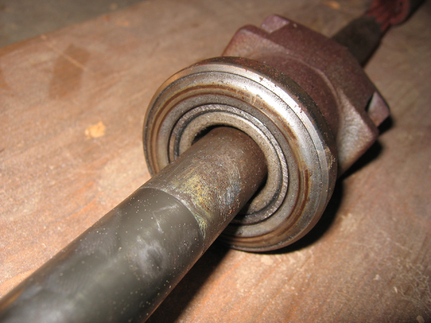

OK... you got me thinking.
I did originally put some grease on the shaft where the TO bearing slides, but not on the arms (sort of "U" shape) that contacts the casting that pushes the throw-out bearing. I'm going to try to attach some pictures I took when I had the tractor split...
Note the arms with the shinny surface. With a little patience, I could try to get some grease on those arms through the inspection port with the orange plug.
I've also included a closup of the old throw out bearing (no grease fitting) on the old shaft as well as the split tractor. Boy, that's a great way to get to know your tractor, but I'm not really looking forward to doing that again!
Someone else suggested adjusting the clutch for 1/2 - 3/4" free play. I've got a little more than that now.

Ahha! adjusting the free play of the clutch pedal seemed to make the rattle go away. I reduced the free play down to about 3/4" of pedal motion. Also, for good measure I sprayed white lithium grease into the inspection port aiming for the arms that ride in the casting. It's 30 degrees out there now and once it started up I noticed no rattle even after letting it idle for about 15 minutes. At least I can sleep better knowing I won't have to split it again and that it's not damaging something.
Now bring on the snow!
