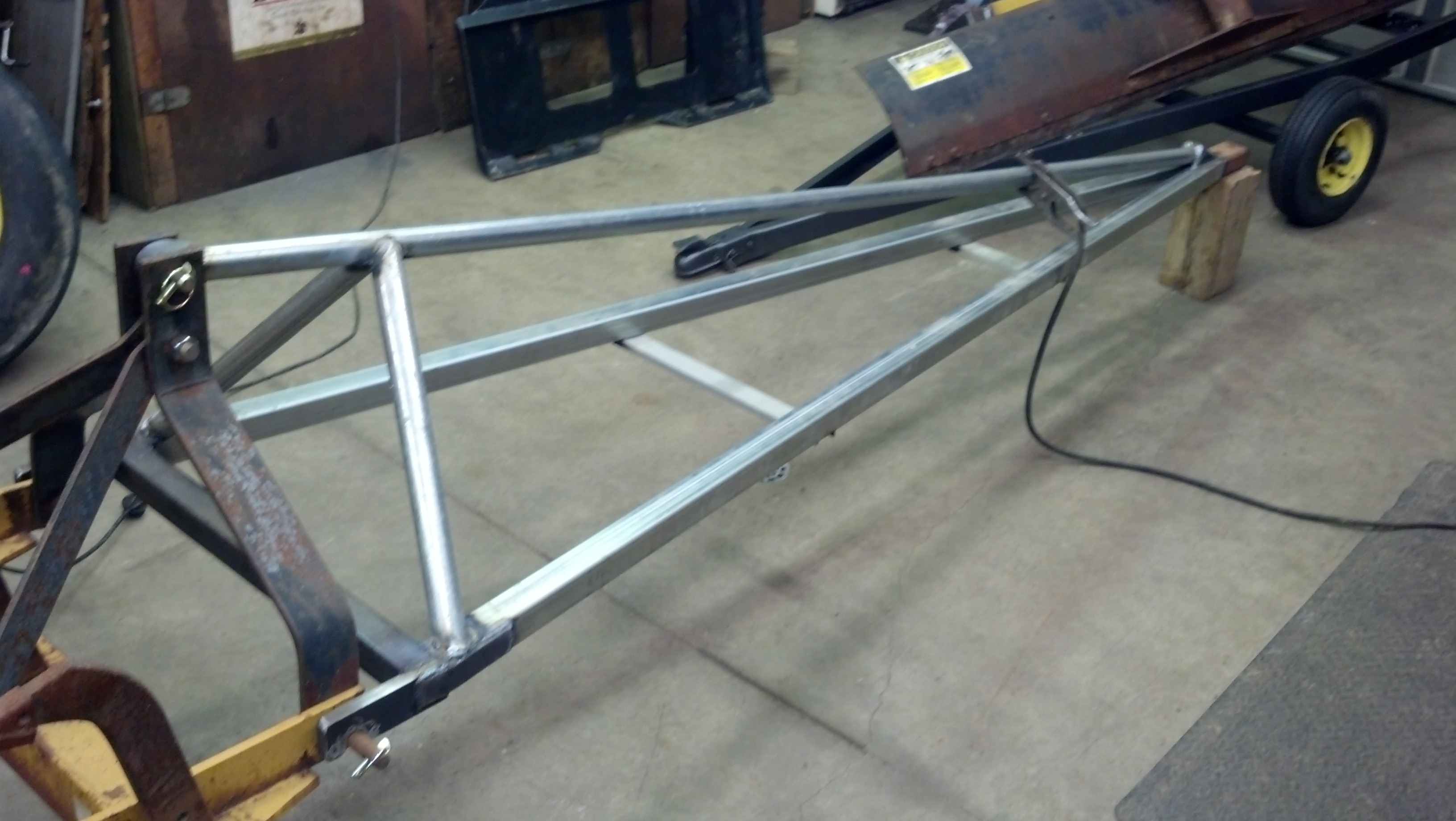

I'm building a tongue to convert a 3PH box scraper to pull type with hydraulic lift on the backside. The box scraper will be convertible between 3PH and pull type using the upper and lower 3PH connections to mount the tongue. The tongue will be "A-frame design with the 2x2x3/16 angle or 2"x1"x3/16" channel iron making up the two lower members. I have these materials in stock so trying to make use of them.

Looks like mostly tension and compression forces.
Bruce

Make a tubular tongue by welding the channel irons together face to face. The box section will be much stronger than either of the separate types of steel. You could do this with the angle, too, but the channel is easier to clamp into place.

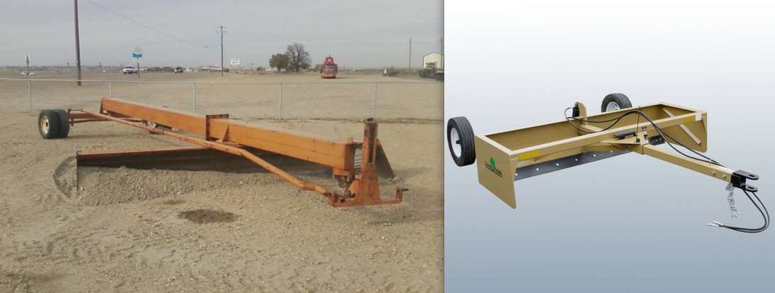

Some folks say that having the wheels farther back from the blade makes for better leveling. I feel that just the opposite is true because having the wheels close behind the blade will minimize any changes in blade height due to tractor vertical movement. I suspect it may be a matter of specific surface conditions such as how far apart are the hills and valleys and can they be leveled in one pass etc.
