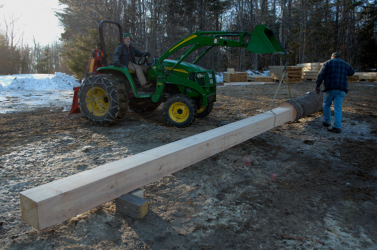

Here's an example of the might of the loader. This 26 foot long pine was 2 feet too long for the sawmill so we had to cut it part way then lift it off the mill and spin it. That's a heavy piece of wood.
