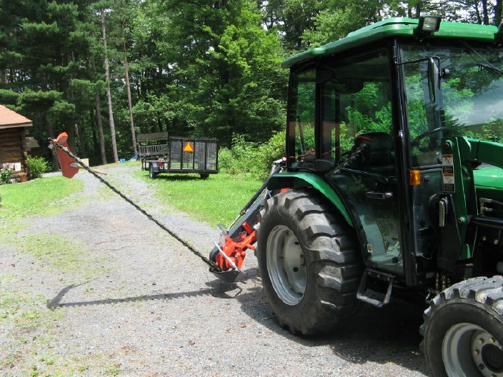

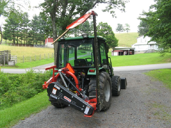

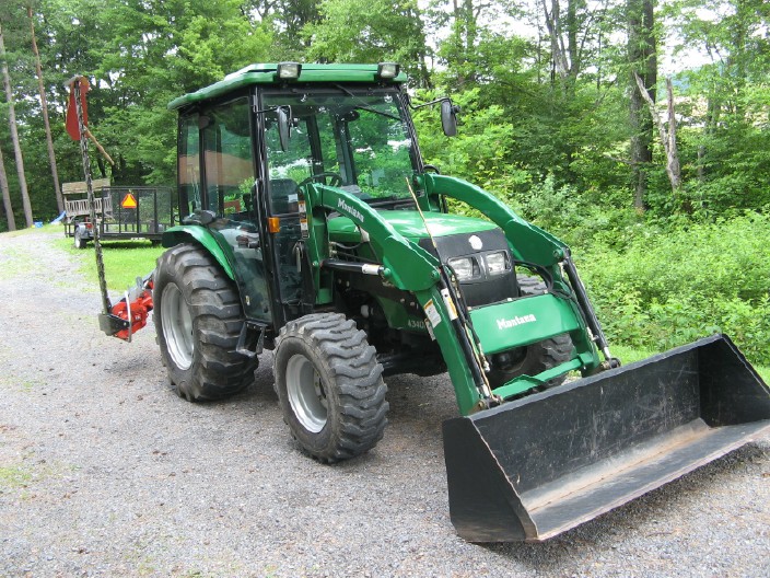

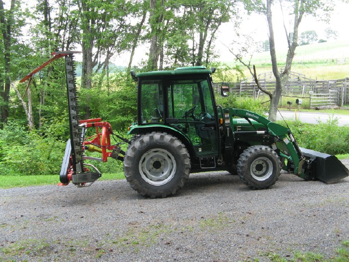

On anther subject, I just ordered a Befco 7 foot sickle bar mower... It should be here in a week or so...
Anyone have one.... If so, how do you like it?
