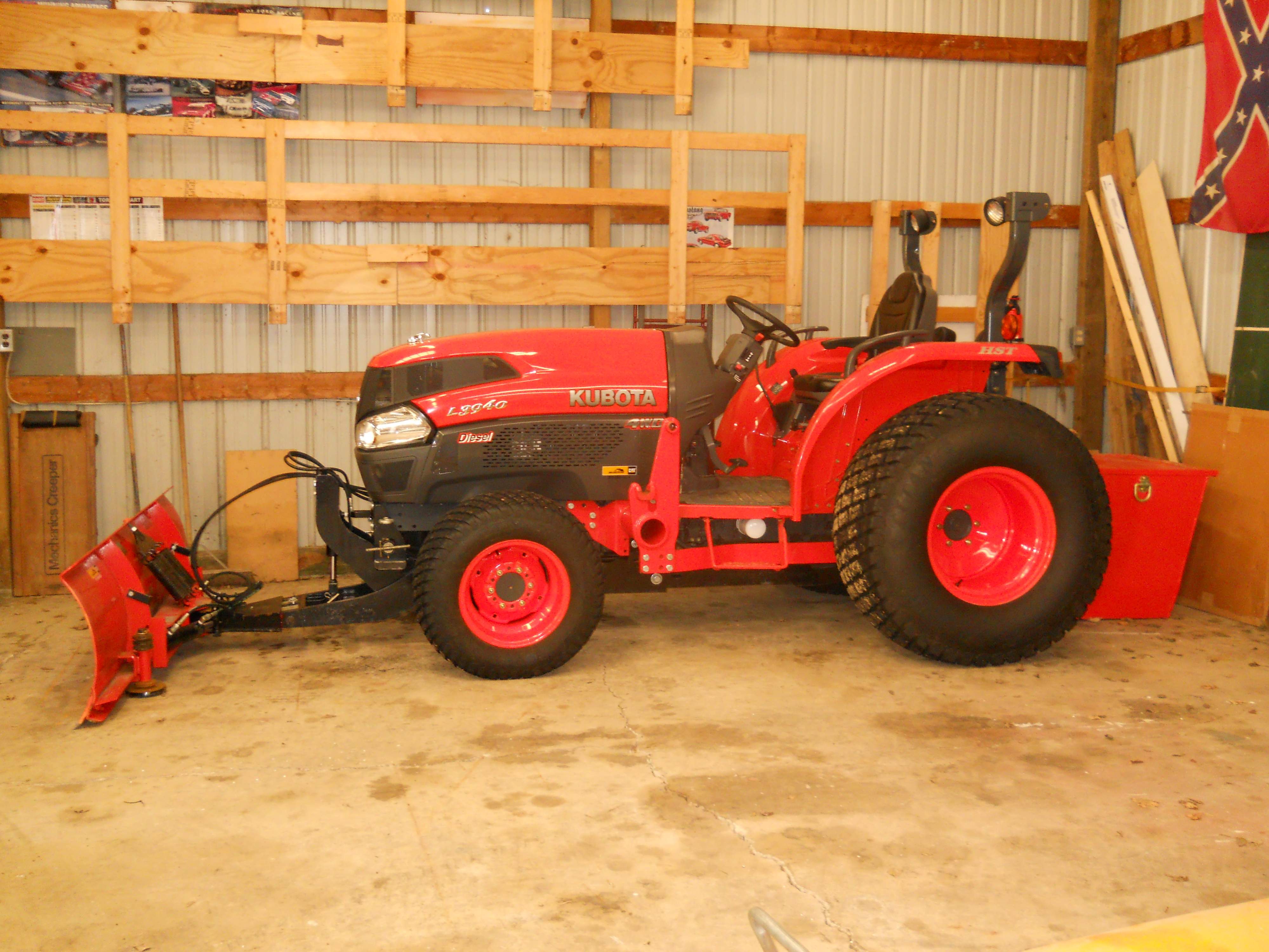

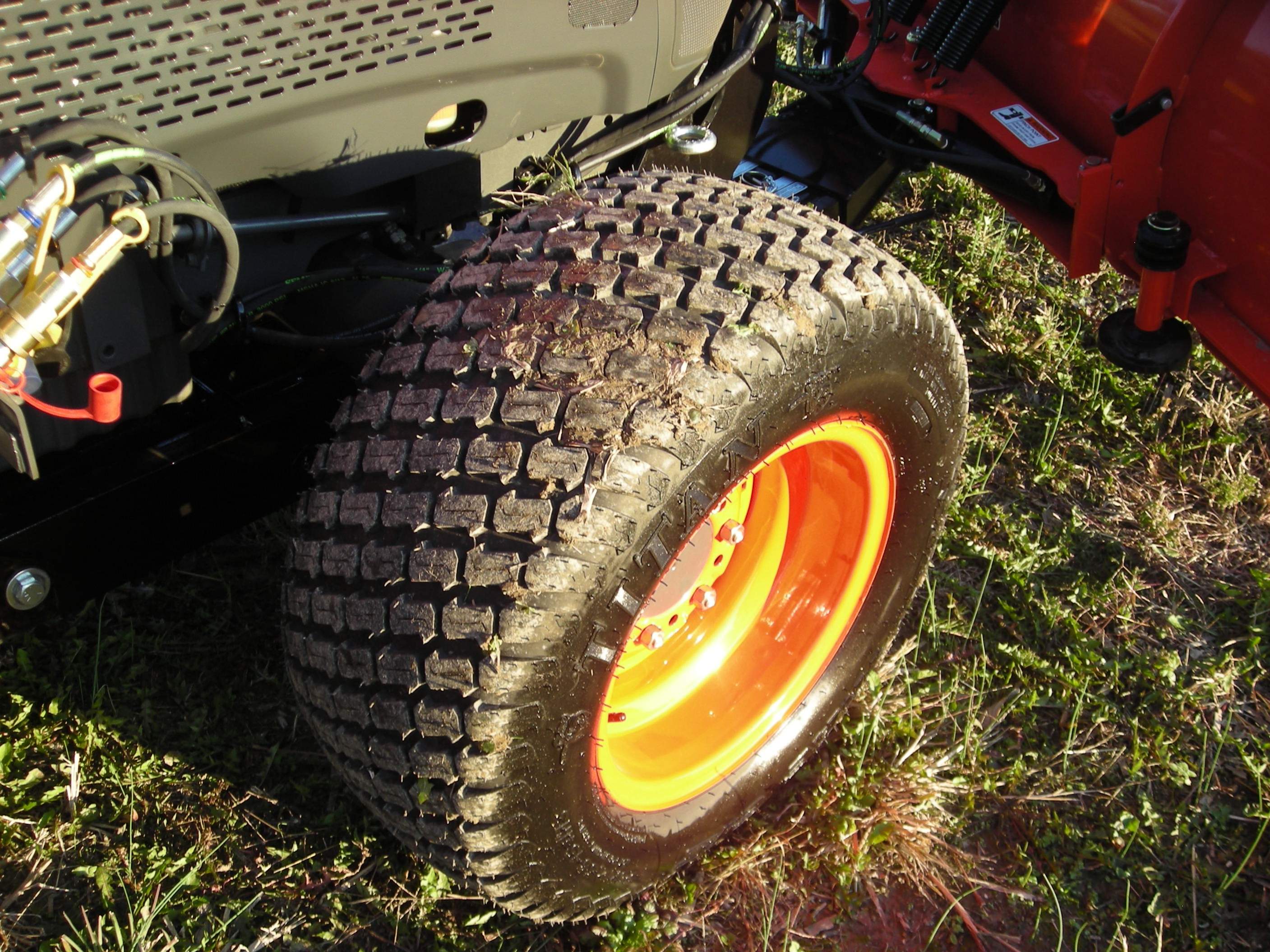

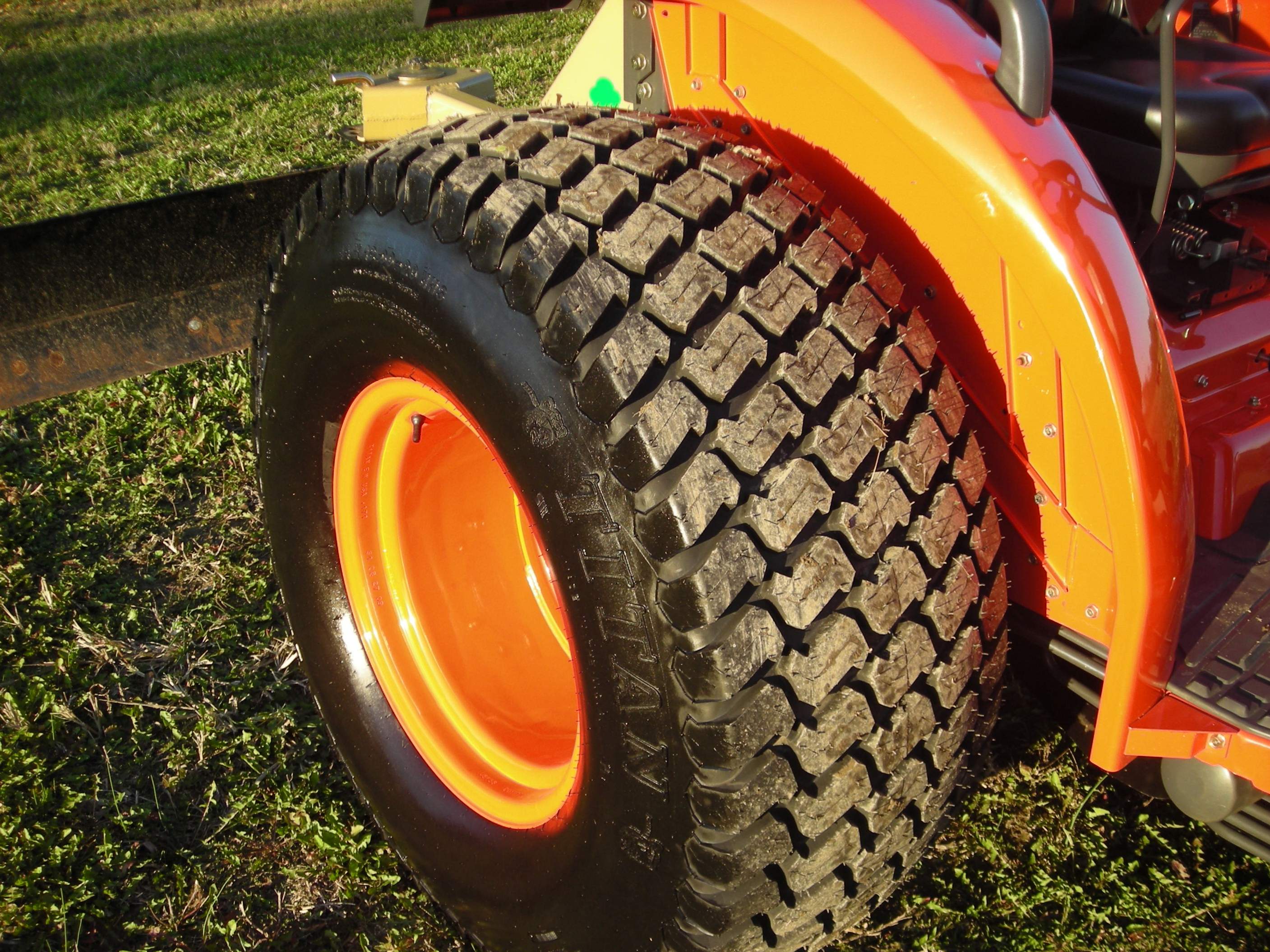

I don't know about the price of the tire/wheel package, you will have to shop different dealers and look for used. Make sure you are getting the turf you want quoted, there are allot of different styles out there.

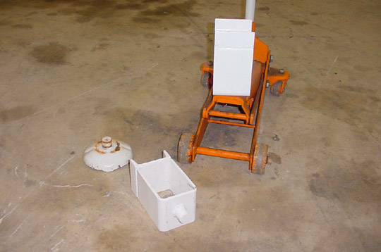

$350 to change? Why don't you do it a your place? Obviously, fronts are easy. CrazyAl 's comment on loaded rears is valid. I have removed and installed loaded R1's on 40hp tractors, they are skinny and not too heavy. But, you have to make sure you stay 'ahead' of them so they keep their balance (no weable wobble and fall down). Always good to have a buddy around. If they are not loaded, should be no big deal as long as your floor jack is tall enough. You will probalby have to adapt your floor jack or go buy one that has a taller reach.
I only have one set of tires. My turfs do an excellent job in the snow.
Philip
