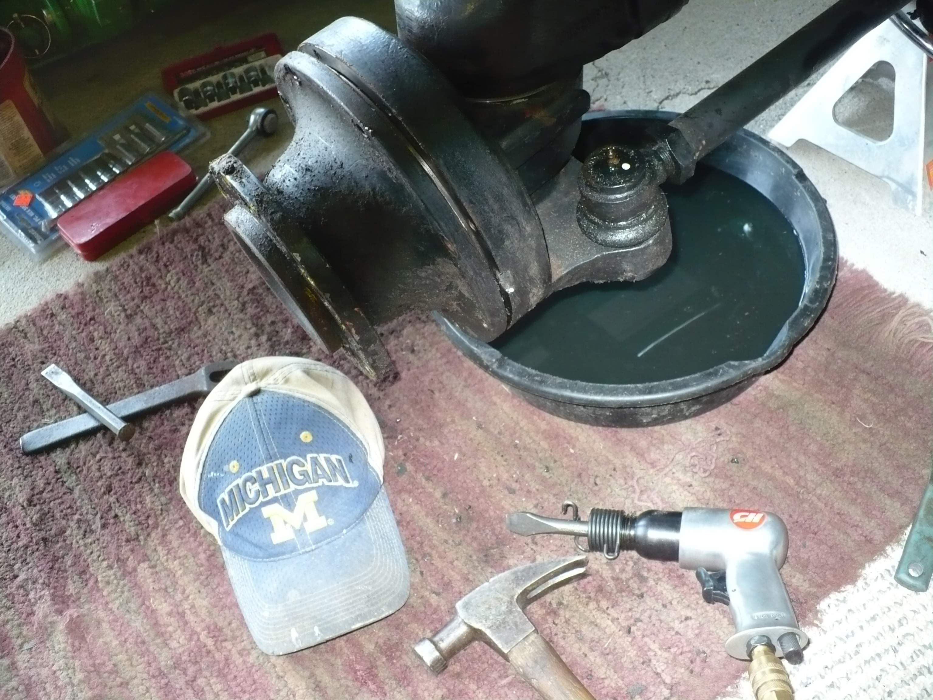

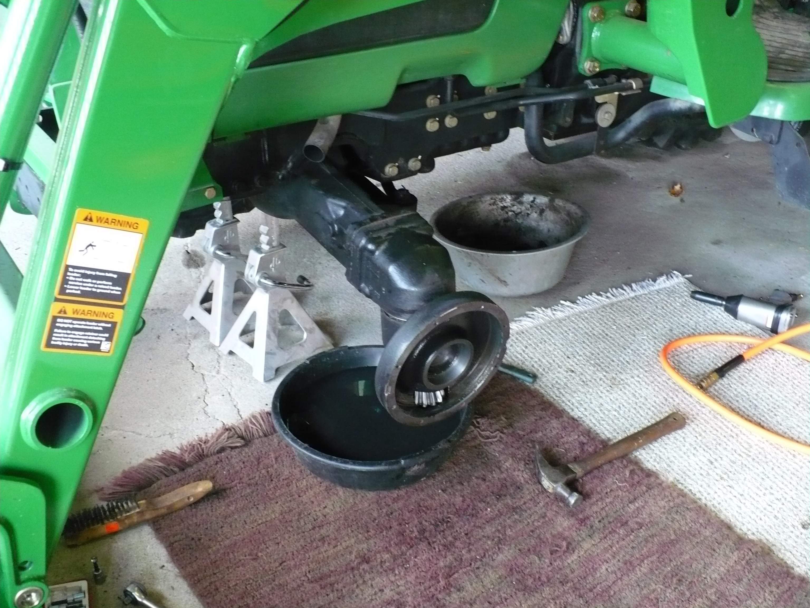

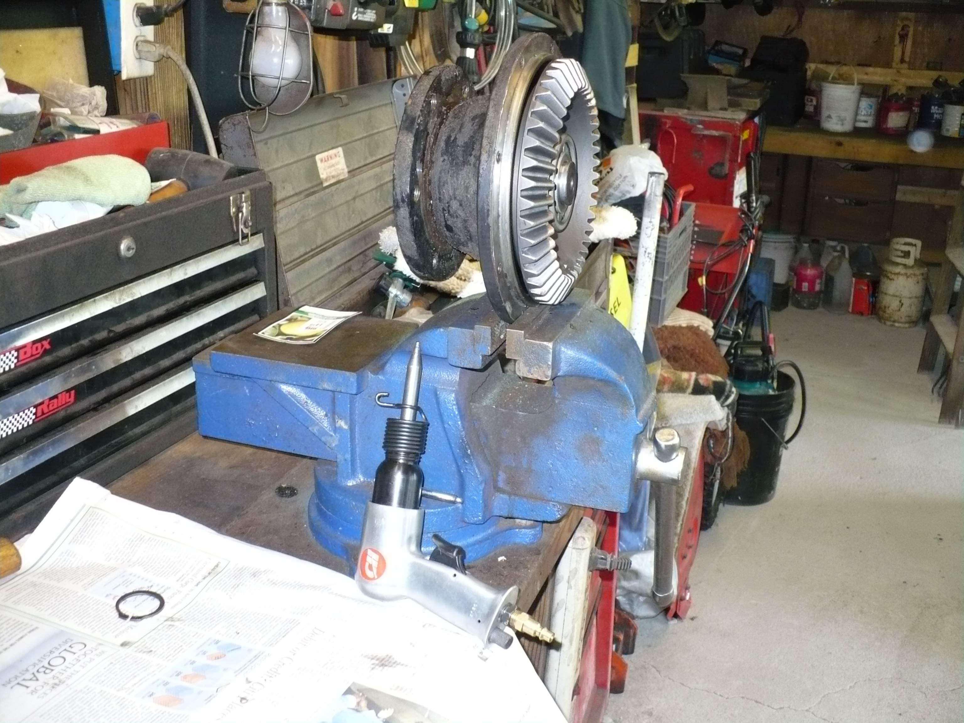

Todays project has come to a halt and I need your help. I am stuck in the middle of a project to change the leaking seal on my left front wheel on my JD4410. Many JD compact tractors are identical or very near to the one pictured. The wheel came off easy with air gun, the hub asm with its eight bolts comes off with a low power air gun. The hub wheel asm breaks free easy by use of a air chisle in the indent area provided to seperate the two. The asm is in my very large vise and no gear puller nor my bearing puller will disassemble the asm pictured. The "C" clip was easy to take off. The service manual calls for page 638 = item #6. Press the hub shaft (I) from the final drive cover,bearings, and bevel gear. I do not have a press.
Anybody have any ideas where to go to pay for a press job or is their a way make a quick press at home? You experts who did this in the past know if I will need to press it together after I get it apart or can I tap/hammer the hub shaft with splines back together? **** HELP ****SOS

If me, I'd take the part to my Deere dealer and ask that they press it apart, put in the new seal, and press it back together. That would be me. I wouldn't expect any flak from the service dept. and would expect to pay the labor charge.
On the other hand, it might give me an excuse to go to HF and pick up a cheap press as I've put it off for a long time now. Don't want it in the way of other things. :)

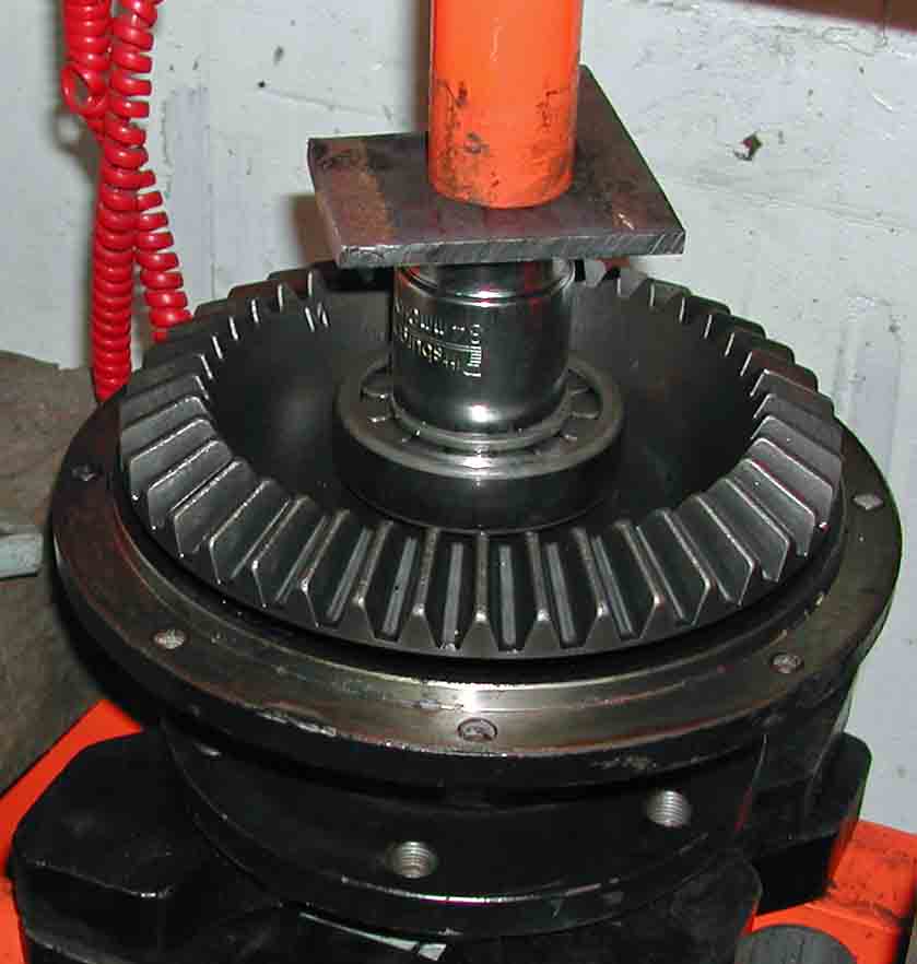

Yeah, you have to use a puller and a press....that's a big ring gear,
and the interference fit is tight. My axle rebuild is buried in my 4300
project. This photo is when I was pressing the bearing back on, using
a 34mm socket.
In the old days when I had no press, I went to machine shops or
transmission shops and they did it while I waited. Good luck.

Approx 60-miles of driving and job complete. I started at O'Brian's garage he had a home made press. We paused and he recommended I go to Thompson's garage. At Thompson we sized it up and he sent me to
Alltrade machine shop. Mike pressed it apart, pressed in the seal leaving a slight lip as JD showed on the new seal instructions and pressed it back together using a little RTV sealer on outside of the seal. It took him about 15min and he asked for $20. I payed him $30. and told him I would come back in a week or so with the right side.
I recommend doing both sides at the same time the main time slowdown was draining the fluid and now I have to do it twice and waste more fluid. No way would I try to reuse it. Use a low power air gun to disassemble to make sure of success for the wheel and 8-bolts on the inner-hub. The impact chisle/hammer splits the inner-hub off smooth and fast when applied to the indented areas used to seperate. You can have it dissassembled and on my vise in 10 min. The slowdown is the messy fluid.:D:thumbsup:
