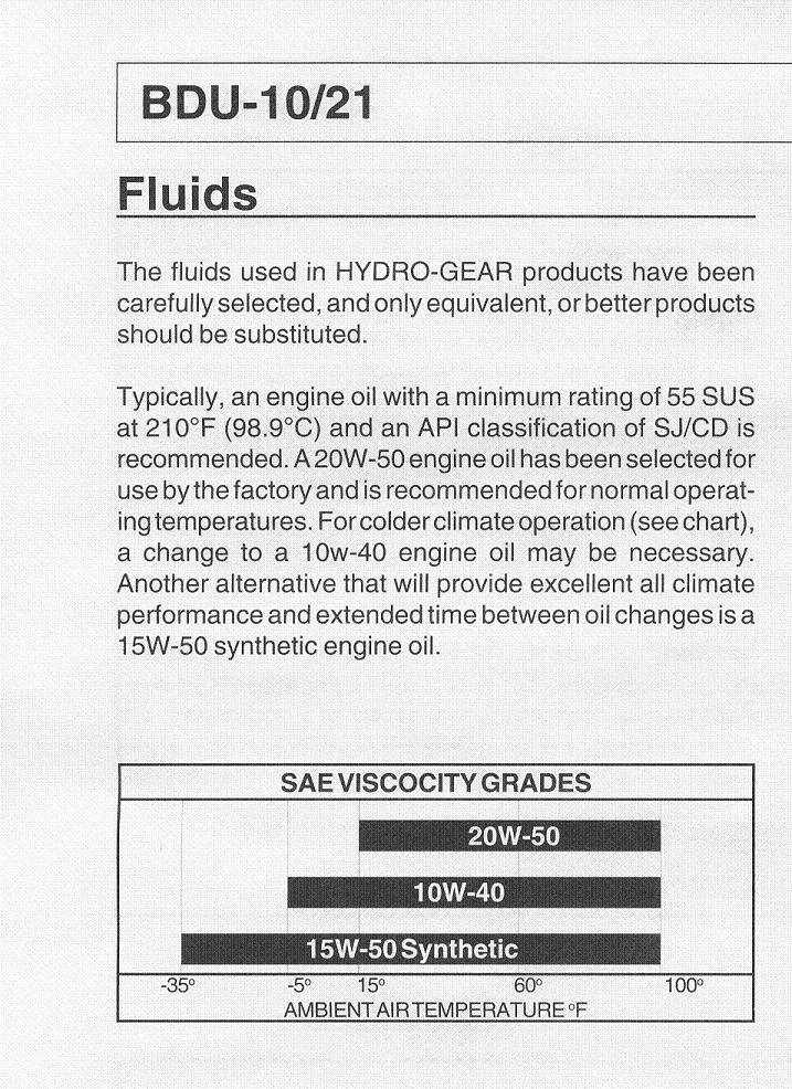

The HydroGear service manual for BDU 10/21 hydros states this:
attachment.php
Now, I have not substituted fluids on my 3225 yet but if I ever have to do anything major to it, I might.
Use at your own risk.;)
   / Changing Hydro oil filter #7
Peavs,
Last year I became frustrated with the differing opinions on the cc oil and what should and should not be used in the cc tractors.
After a phone conversation with a senior person at hydro-gear I posted info similar to yours in this forum.
Currently I am using Mobile-1 15w50 full synthetic in my 5254. This was after a phone conversation with hydro-gear and their recomendation to use this oil. Wal-Mart was remodeling and I purchased my oil for only a couple of dollars a quart!
Alan
   / Changing Hydro oil filter #8
wojnaroski said:
After a phone conversation with a senior person at hydro-gear I posted info similar to yours in this forum..
As did I some time ago, but specifically in regards to the 2005+ 2500 series machines, not the 5000. The fellow I was in contact with at HG was very friendly and helpful, but his hands were tied in recommending an alternative. All HG does is ship the hydrostatic drive to CC. CC then supplies thier own differential gearing, housing, axles, etc... and bolts the Hydro-Gear drive unit to it. The HG guy agreed that a 40wt or 50wt is typical spec for the drive, but he had no idea what Cub wants for their differential portion since they are a shared sump. Again, it's just a slow speed differenial, not rocket science, it would probably run a long time on any oil, the HG guy just didn't want to implicate himself with a bad recommendation.
Joel
