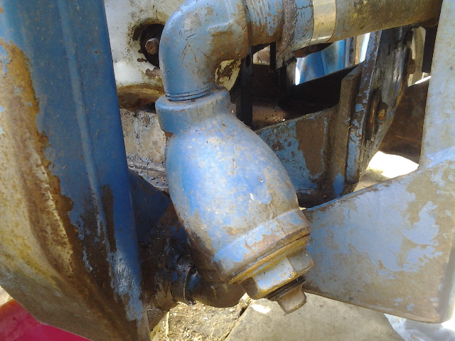

Does anyone know where i might find a manual or description of any filter locations on ths loader. It is branded shawnee made by shawnee manufacturing co. Inc. Kansas city
Serial # CL 1366. No other numbers . The photo shows a bulbous looking fitting located between the reservoir and the pump. It has a threaded end that could hold a filter but the shape is odd.
