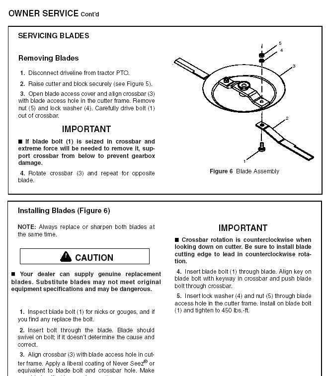

Here are the instructions for my Woods BB60 mower.

Unfortunally, I do not have an access hole... I do have a drill....

The problem mine are torn up pretty bad. I need to replace them and I need to figure out what is the best way to get them off.
   / Changing Hog Blades. #7
Roger, I bought new blades for the 4' Bush Hog brand brush hog I had and was actually surprised at how cheap they were. But as far as how to remove them, it depends on what brand brush hog you have. My Bush Hog (and one Woods Brush Bull I've looked at) had an access hole in the deck, but my Howse did not and it would have been very difficult to get a wrench on the blade bolt nuts under the deck. I had to pull a very large cotter pin from the castellated nut on the output shaft of the gear box, then use a gear puller (I just used two 5" C clamps and a short, stout piece of iron - C channel) to pull the stump jumper off, then removed the blades from the stump jumper.
