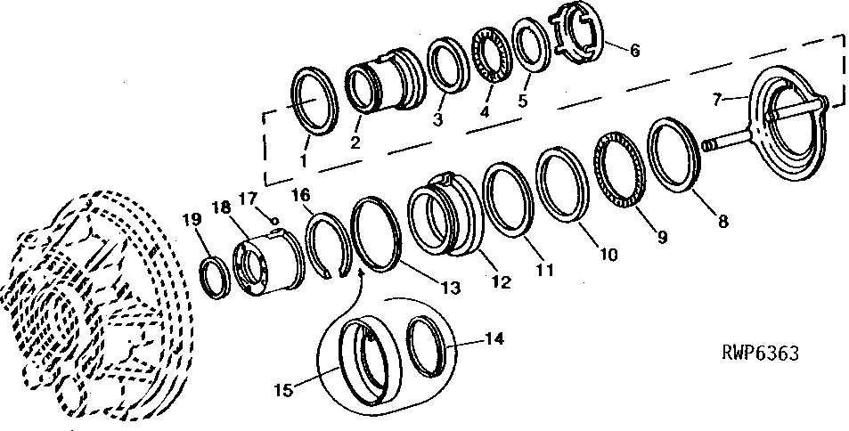

I would suggest renewing the seals in the operating pistons. This operates different from a regular dry clutch as the pistons apply pressure to the clutch disks(both traction & pto.

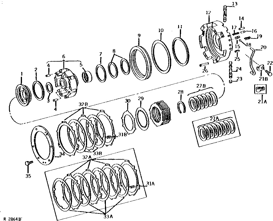

   / changing clutch on 4430... #3
In addition to the operating pistons as TxJim suggests, I would recommend disassembly and inspection/resealing of the hi-lo assembly.
