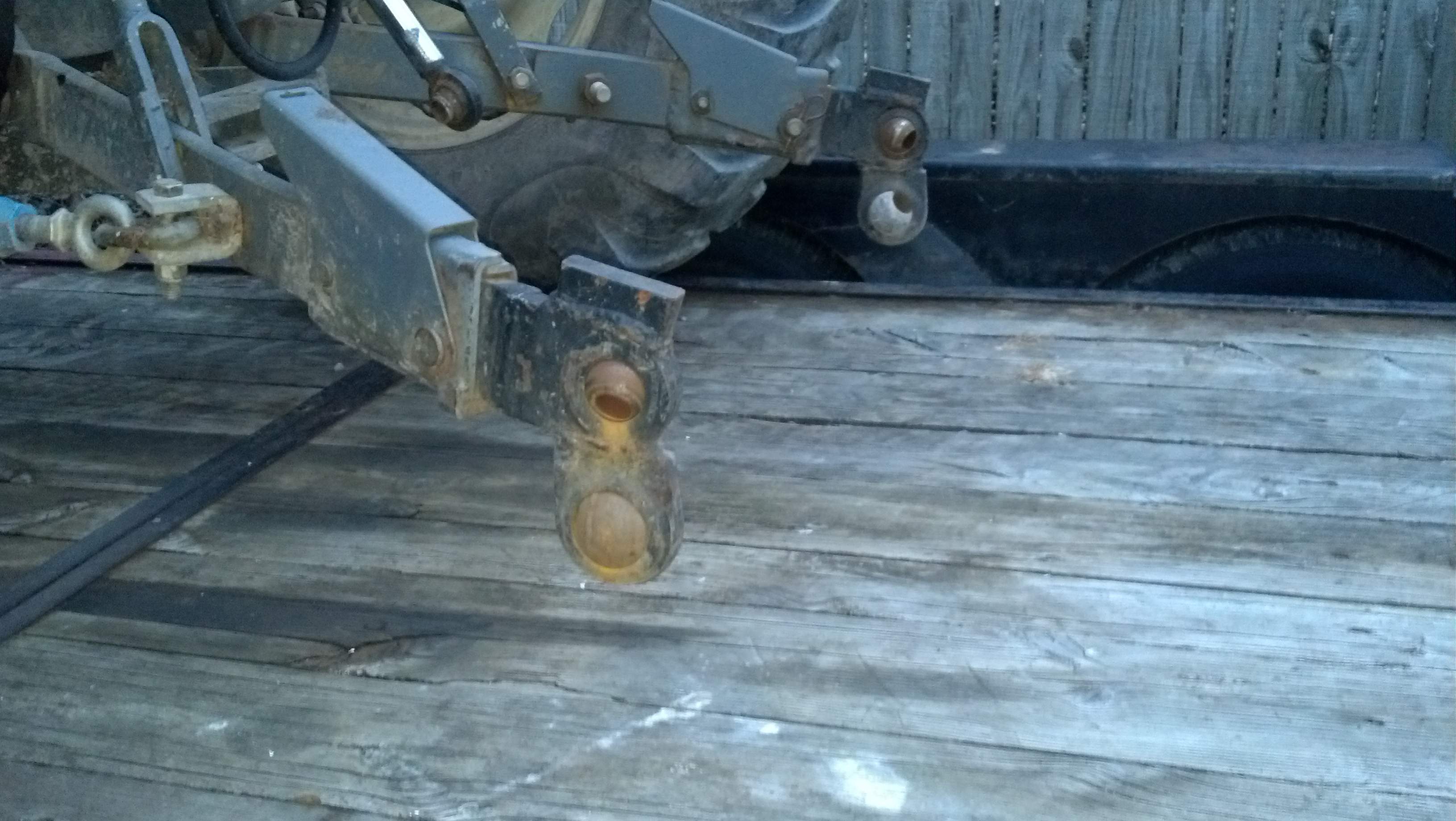

   / Changing cat 1 to cat 2 on kubota L4200 #5
I just welded some cat 2 directly to the cat one arms so i could use the emplements without pulling parts on and off durring the day. its worked good for years.
