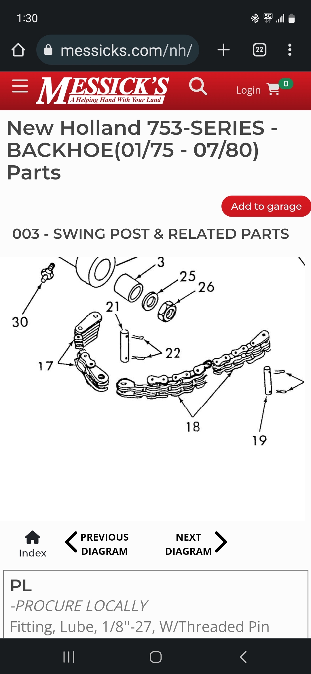

How do you disconnect the chain from the post ? Is it pinned or bolted ?
/ changing a backhoe swing chain #5
It is pinned in the middle
