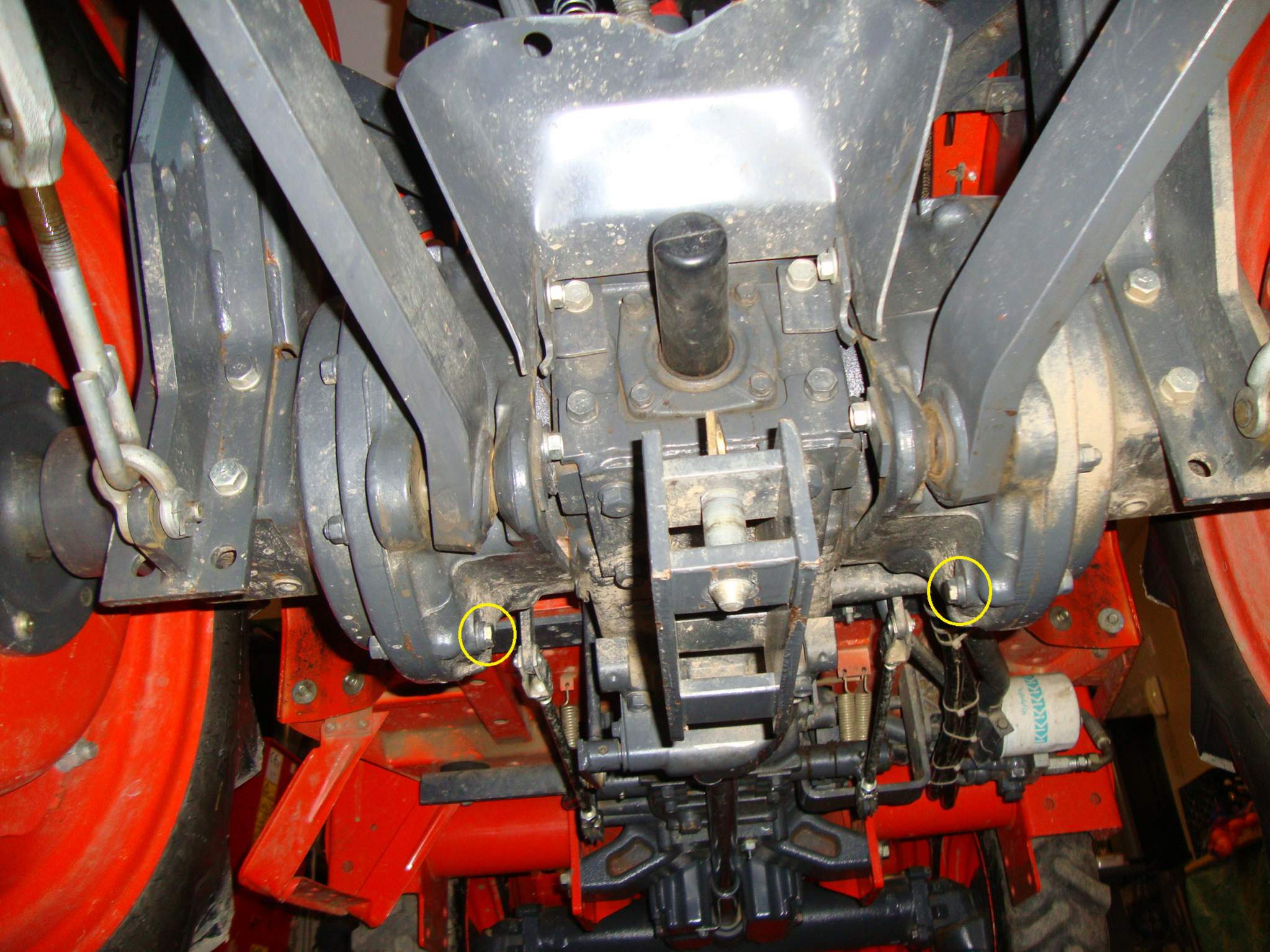

I am doing 400 hour maintenance on my L3800 HST. I drained all of the SUDT, replaced both filters. I bought a 5 gallon and a 2.5 gallon container of SUDT fluid. I put the 5 gallons in and then started to put another 1.2 gallons in. According to the manual, it takes 6.2 gallons. I cannot see the oil in the check window. The tractor was on level ground. I ended up putting in the 5 gallon and 2.5 gallon and I still do not see the oil in the glass. I don't want to overfill it. In the check window I see the white dot and it does not have a yellow tint to it, so I doubt it is overfull. Any suggestions? THX.

How much did you drain out, and did you check the sight gauge before you drained the oil? The window will be very WHITE when empty or low. If there is any kind of color in the window, then there is oil in it. I would get a clean drain bucket and drain off a couple of gallons and then take a look at the window. Ideally, you want the oil level to be mid way up the window.

I did the same thing on my L3700SU. Luckily I quit at 7 gallons. I thought there was not any oil in the glass however it is so clear I could not see it. I had a new drain pan so I cleaned the side of the tractor good under the site glass and removed the site glass just over half a gallon ran out. Put the site glass back in and waited my wife to slowly pour some as I watced it in the glass. I wound up with 6.5 gallons roughly to the top of the glass. I removed all plugs and left mine open overnight.

Remember that the sight glass is plastic and when putting it back in do not over tighten it or it will crack at the threads. If you're going to pull the glass and drain the oil down that way, why not just pull a drain plug and dump a couple of gallons and then SLOWLY refill it and watch the gauge. Like I said earlier, when filling, put the level at half way in the gauge so that you will always be able to see the difference.

I had my wife keep a close eye on the site glass and started draining. There was no way I was going to get that site glass out unless I wanted to pull a bunch of stuff out of the way. After draining 2+ gallons, she could see the oil in the site glass. Success. That what really bothering me. I wonder what would happen if I would have left that much SUDT in there.
