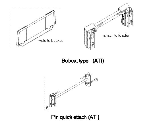

Quick Attach buckets are common on tractors from 30hp and above, they use the same system that skid loaders use. On tractors below 30hp the QA system is usually not even an option. Some companies like ATI will offer a quick pin system for the smaller tractors that allow you to remove the bucket very easily, you simply pull a couple pins and the bucket comes off, however there are vew optional attachments for small tractors below 30hp. At 30hp on up you can usually get different types of buckets, grapples and pallet forks. Any tractor that does not have a QA system will have 4 pins that hold the bucket onto the loader.

Here are examples of both of the ATI quick attach systems.

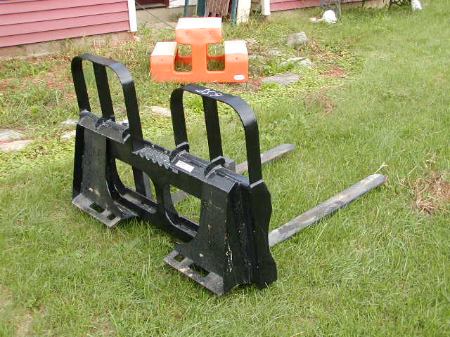

I have the QA on my DX40 loader, it is the quickest changout of implements, I have ever seen, I'll attach a pic of my Forks, which is one of the most versitile attachments, from moving brush, trees, and of course, stuff on pallets.
How it works is you drive up to the implement and hook the top edge to the under side of the lip, pick up the implement and push down 2 levers, all done! But the only issue with this system is that after getting it, you will have the overwhelming urge to buy a trench bucket, grapple bucket, forks, and anything else you can think of. /forums/images/graemlins/smile.gif
