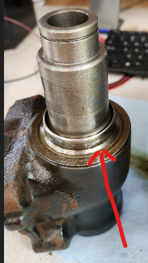

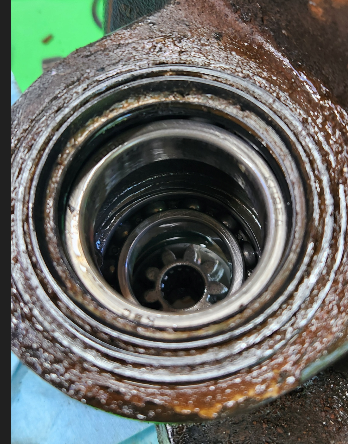

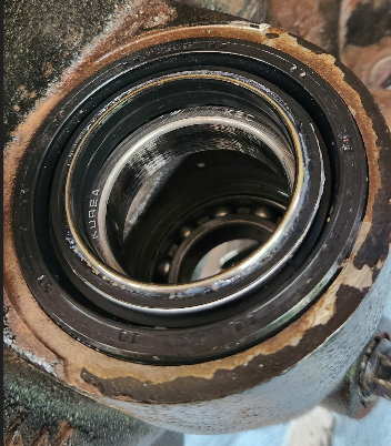

When replacing an oil seal for the front spindle the oil seal (Part#MIU800757) now has a steel inner ring that is rubber coated. This requires removal of the collar on the upper case, which came off easily with a screwdriver.
Old seal:
New Seal:
