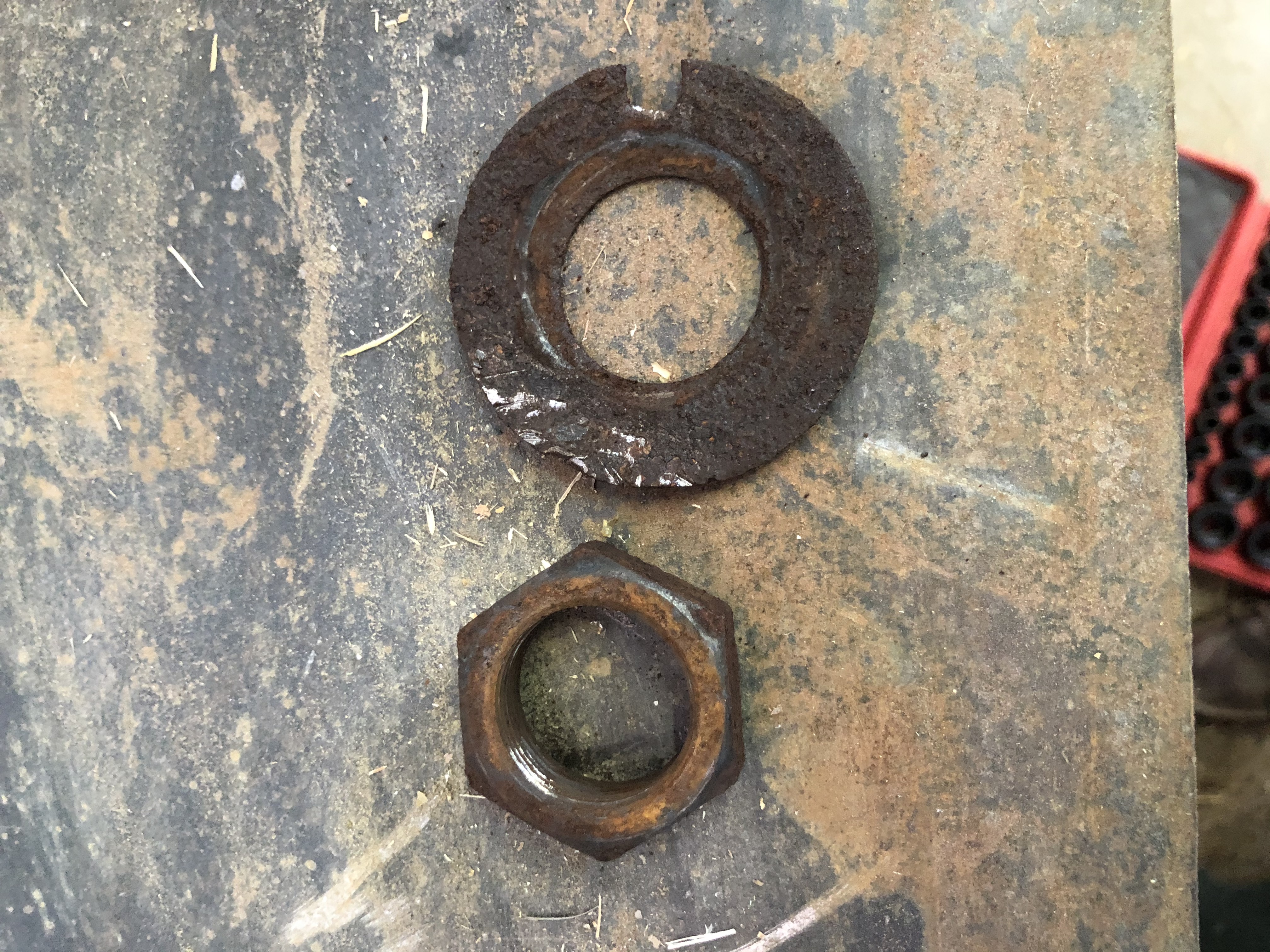

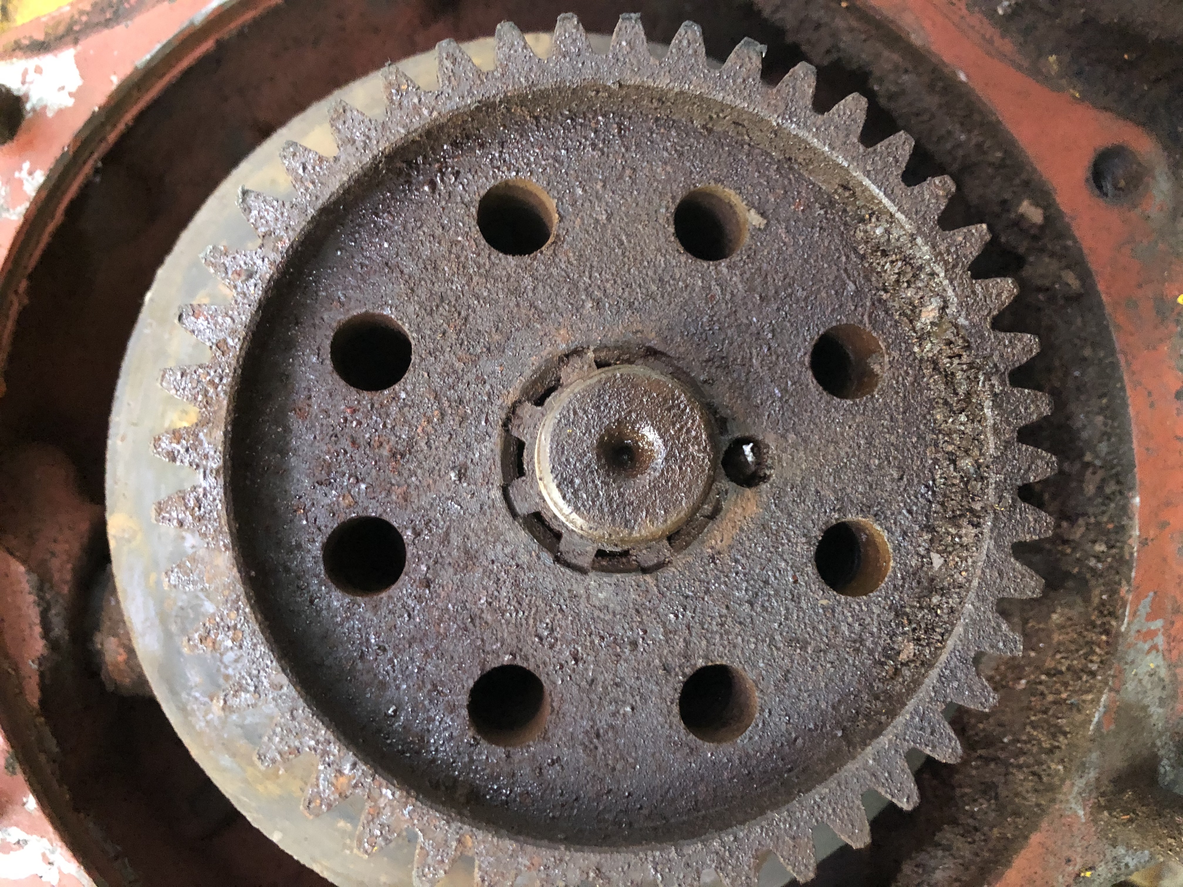

Ok, I think I am getting close -- but, I can't get the inside pressure plate off of the machine I found a diagram on a previous thread that showed the parts,
and how they connected, but mine seem to be a little different IMG_3533 3.JPGIMG_3534 2.JPG I am trying to figure out if the hub should just come of, or if I need to take out the multi-toothed Washer, or nut, or whatever it is before it will come off?
Because right now it doesn't want to come off, Also, as I said I saw the diagram of the clutch parts on a previous post you did, is there somewhere I can get a copy of that manual?
