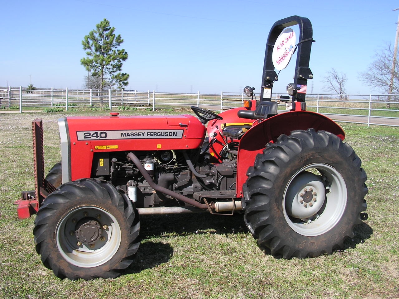

I converted my 240 many years ago. I had a flange that fit the manifold, so I took it to a muffler shop, they used the muffler and made the exhaust pipe,
