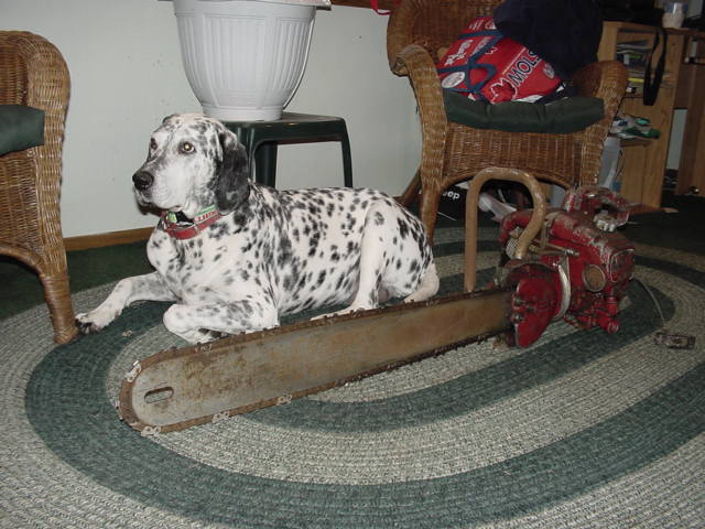

   / chainsaw chains #5

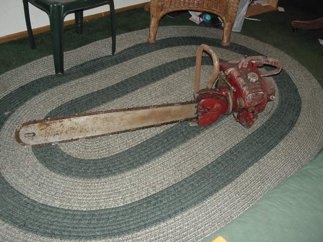

   / chainsaw chains #6
One more. I think the saw was made in 1957.
   / chainsaw chains #8
</font><font color="blue" class="small">( One more. I think the saw was made in 1957.)</font>
Oh boy. A chain saw sitting on a rug in the house. Are you single? If not you have the most understanding wife on this net.
I don't even take a chain saw into my shop without preparing a spot to sit it on. Cardboard to absorb the chain oil that seems to get everywhere even if you wipe the saw off.
