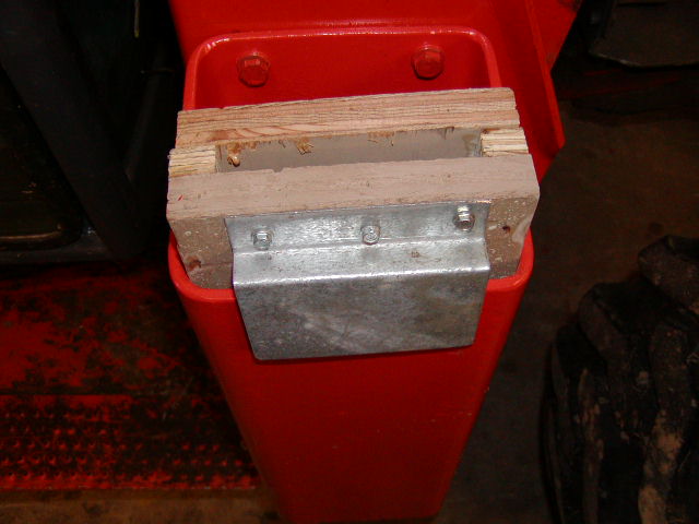

This is a 6x6" sq tube with bottom, bolted to the side of my loader. Set in a wooden scabbard for the chain saw to go in and you are ready to roll.
   / Chainsaw carrier #7
Neal I like it. It's simple in design yet looks like it would afford your saw with very good protection. I'm also thinking that the same 6 X 6 tube might also work double duty to hold a couple of chains when you don't need the saw.
I'm printing and filing your idea for duplication at a later time. Thanks for the ideas......
