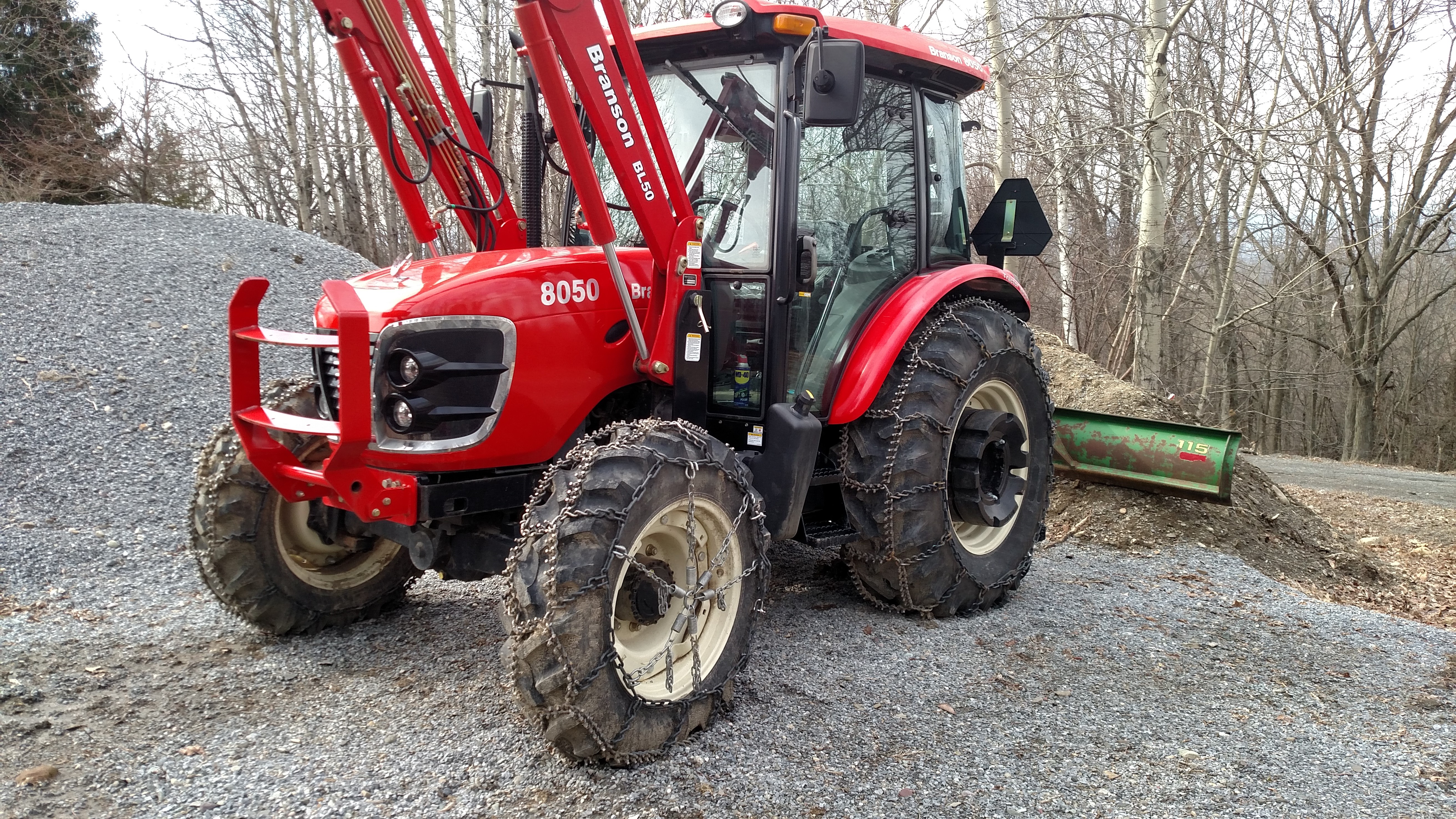

I've posted a few times;
as far as chains go the Euro style such as the Aquiline are the best working, smoothest riding, and best working type of traction chain I have ever purchased.
   / Chains? #6
Oh, ouch - LouNY - you use the phrase "smoothest riding" when talking about chains. The HD set I had were around $650 for both sets - as I remember. $450 for the rears and $200 for the fronts. They were what I would call cross link - fantastic traction - rode like a cob. Certainly glad to get the new Kubota M6040 - tips the grain scales @ 10,100 pounds - no need for chains to clear the driveway with my rear blade now.
   / Chains? #7
The Branson 8050 in the picture is heavier then that, with just the rear chains which is it's normal winter configuration I can run down the road at 15-18 mph with no excessive vibration or rough ride, with the fronts on 15 mph is the max on the road, I usually only mount the fronts if a major ice storm is forecast or having to work in deep snow in the fields.
I can not even consider going on my driveway without the chains in the winter, it's quite steep 14-16 degrees or 24-29% slope, it can be a ride at times.
We run the same style chain on the tractors that we feed outside with in the winter, A CIH Puma 125 and a FNH T6040 they both are over 15,000# and go a couple of miles each way on pavement to get to the winter feed lots.
This style chain has much more traction than any others we have used and a smooth ride, which is nice for the operator but more importantly is easier on the equipment.
I have used the smooth twist link, the bar reinforced, the H patterned, and the double ring chains, with 2 and 4 link spacing and none of them can compare.
They are not inexpensive by any means, I'd hate to add up every thing I've spent on chains and studded tires.
