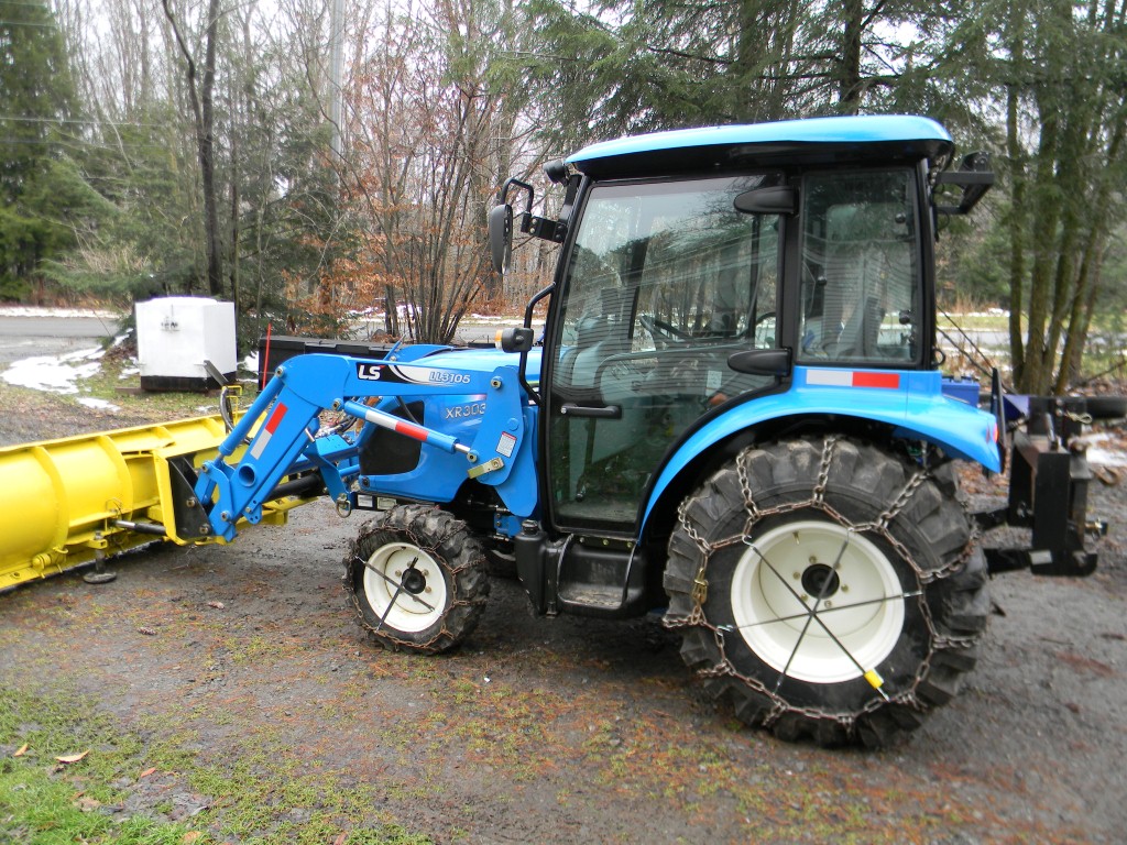

I use chains front and rear. Rear chains are standard 4 link ladder. Front chains are V bar. They do help steering by biting into the snow and ice. As Ray said, Less angle on the blade helps too. You don't need much angle, just enough to make snow go off the angled side of the blade. Rear tires are also loaded. If at all possible don't use the float mode on the loader and just lower the plow blade so its just off the surface. That keeps the extra weight on the front tires. It all depends on the snowfall we get. Last season was pretty light so I never even used the chains. I don't believe having front chains will cause any extra stress on the drive line because you are still going to have slippage on snow or ice. It may be a problem on blacktop.
