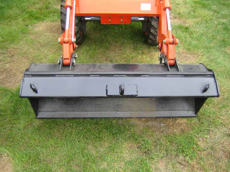

Here is a photo of an arrangement I have. Grab hooks on both ends and a slip hook in the middle (with support plate). You need to specify what size chain you'll use as the "slip" hook can just be a size larger than the properly sized grab hooks.
