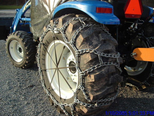

I don't know if this will help but here's a picture of chains on my TC35A.I bought them for $225.00 last year at Tractor Tire Chains .Com . They work great but beware when you try putting them on,they weigh about 75 pounds apiece,and when your not riding on snow they will bounce you to pieces.This year I tried something different,I put a set of ladder chains on the front tires only and plowed,It worked out very well and the chains were a snap to get on and off by using the loader to lift the front tires off the ground. I have a 9 foot myers plow on my tractor and I plowed 11 inches of snow going uphill with this setup.It also helps when turning with a blade full of snow.

Mine are similar, very good traction, but a bear to put on. This is the first year I haven't had a straight gear tractor. I'm not sure how the hydros work but mine is a hydraulic shuttle. The rears won't turn even with both jacked up, so you can't roll the chains on by turning the tires. Used to take 1/2 hour with my old Massey, this time 1 hour and lots of sweat. First time with this set, but still lots of grunting. Worth it, I guess.

Bernie: Thanks for posting the photo. I can get similar chains but my NH dealer suggested that I need to get 3 inches of clearance between the inner sidewall of the tire and the fender. Is he right or not? I would imagine that you have found that you have enough clearance with the stock setup. For snowblowing, when you have ice under the snow, are the front ladder chains enough?

Bernie,
Thanks for the picture. I just ordered a pair and will give them a try. I may end up getting a set for the front too. Driving back to the barn in 4WD I was on a 10% slope (according to my Tilt-O-Meter) and without the bucket loaded and off the ground, the frontend slid down hill. I ended up backing out to the drive and taking a more level route.
I honestly wonder if part of the problem is my driving. It took me a little while to get use to the hydro. I may be over driving the R4s.
