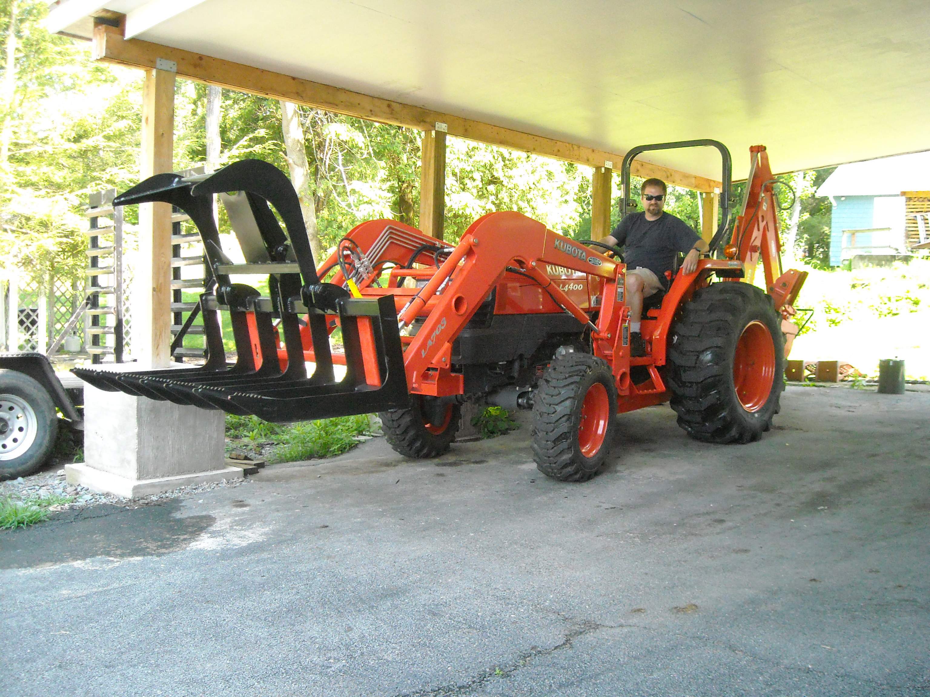

I just ordered a set of the duo style chains from tractortirechains.com. I have a kubota L4400, with r4s. the price with delivery, and a set of stretchers, and a stretching tool was $344.00. I priced 5 other places on the net, and this was the best price. Their customer service was very good, and I am waiting to see the quality. The chains I needed were for 17.5 r24L, so it is a mid range tire. They were up front with me about, having to backorder them. They have called me back, to keep me up to date. I think they are worth a try. I'll let you know if the chains turn out to be junk, or what when they arrive. By the way, My tires are filled. I am doing some land clearing in a wet hole, to make a "plond" (food plot/pond) I have a Grapple bucket for getting the logs, brush etc out, and really need better traction. I live in the northeast, and this will extend my working time A lot
