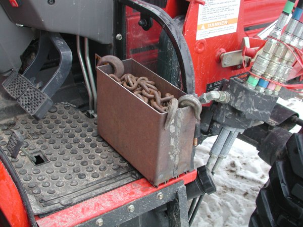

Looked at the chainbox post a while back and really liked the idea but didn't want to put it on my fel so I came up with this idea. It is a box that I welded up out of scrap metal and fitted it on the rt side. It is held in place by the wt and a pin that slips into the window bracket. The pin is on a angle so when you drop the box in it hods it in place so it don't turn. very easy to take on and off. It also dosen't get in the way of getting on and off the tractor or and controls.

another view

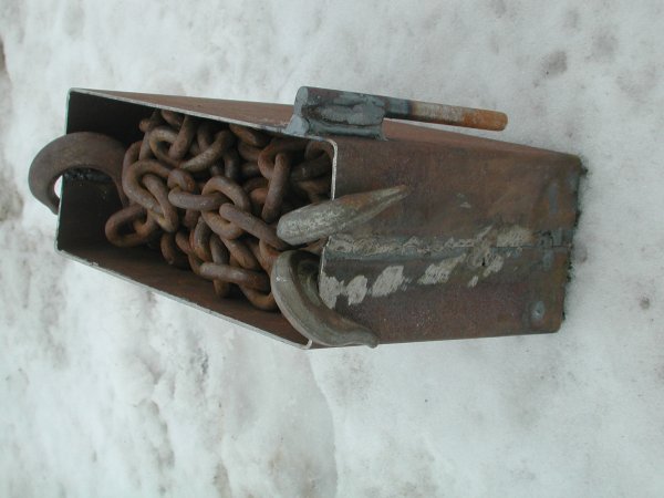

box off the tractor showing the pin from the side

another from the front showing angle

Leaddog, you have been busy accessorizing. There is a lot of room on the platform...seems like a good idea on your location. I read the chain box thread and put the pictures in my project dream folder....but have been thinking about where to mount them. You have given me another picture for my file. Thanks. I've got to get me a welder!
