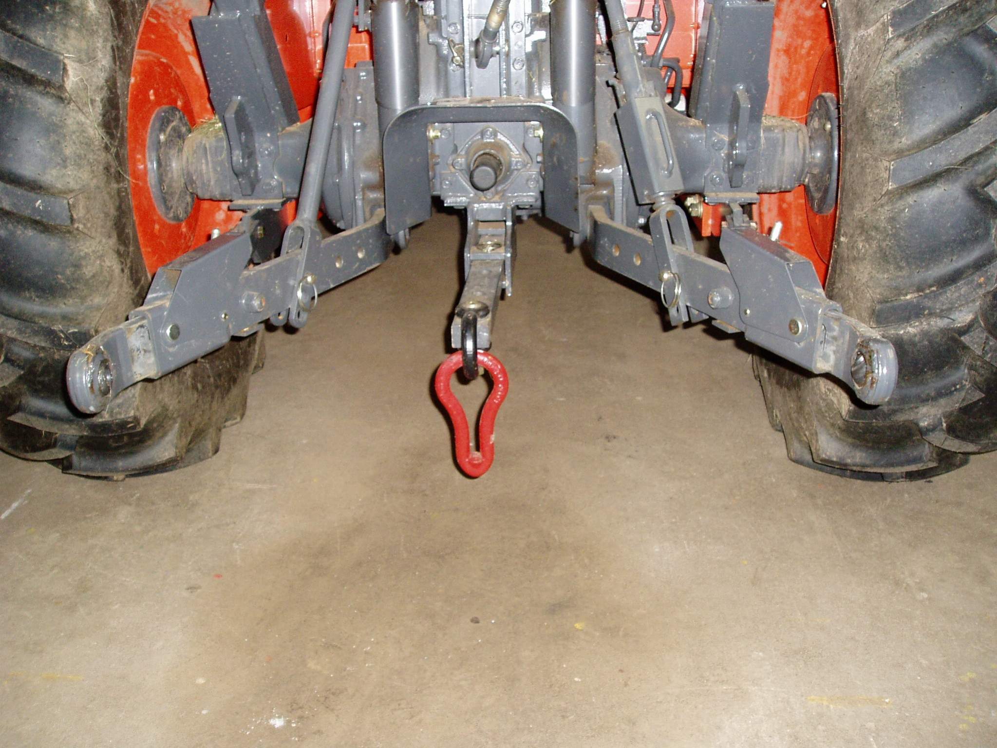

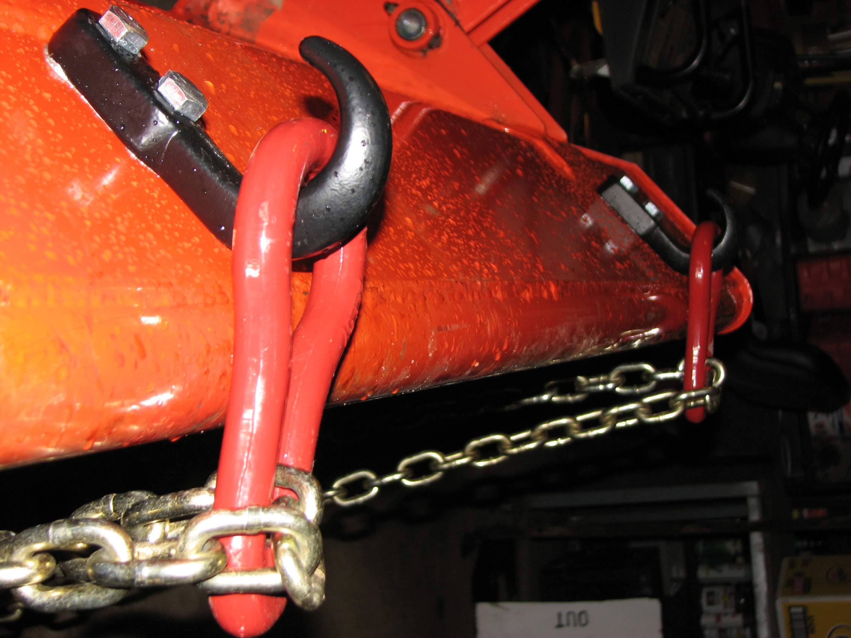

Here's my chain to drawbar anchorage - It's a shackle & banjo link:
This allows fairly quick attachment - probably a little more effort than dex3361's hook. This makes for a very secure & unrestricted attachment to the drawbar. The shackle also is a great place to tie off a rope. I have two slip hooks on the FEL bucket that are also great for working with rope and two banjo links that transform the hooks to chain grabs whenever the need arises:
Remember - try not to pull at an angle to your centerline. If you must do this keep the angle as small as possible to minimize the risk of laying your machine on it's side. Better yet, get a snatch block and some high quality rope for when you get into a situation where you can't avoid and angled pull.
Work safe,
Jim

Hey Jim
I like the Banjo Links, where did you get them? I would feel safer with them in a lot of situations or when skidding multiple logs.

Northern Tool has them, but I think I got mine from Bailey's. Search Chain Grab Link. Where'd you get that swinging hook? That's the first time I've seen one of those and for pulling chain with the drawbar it looks perfect.
-Jim
