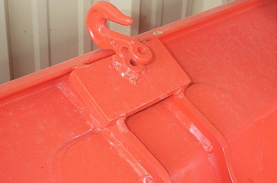

I have a BX2200 with FEL and I welded a chain hook in the middle of the bucket where the cylinder bracket is located. I welded the chain hook to a piece of flat iron, then welded the flat iron to the bucket across the braced area and touched up the paint with Kubota Orange.

You wouldn't have the ability to post a pic on that would you? I have a BX2200 and am going to be needing one of them hooks...maybe 2, but I'd sure like to see how you did it. Like it, or would you make any changes?

Sorry, I don't have that capability at this time. Will have to invest in a Digital camera next. The hook works well. The front of the hook is about even with the edge of the bucket and I've lifted a box blade and other items with no problems. I believe it is strong enough to handle anything the BX has the ability to lift.

Attn: charliebrn I have access to digital camera now and have attached a photo of chain hook that I welded on my BX2200 FEL. Hope the photo will help
