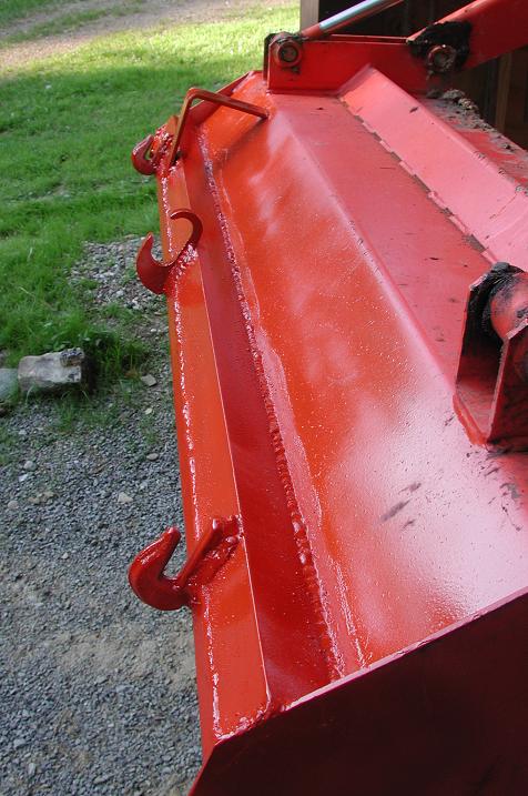

I had a JD 890 and welded 3 hooks on the bucket. If I recall correctly, I welded 3 3" X 4" 7/16" pieces of flat stock on the top lip of the bucket and then welded the hooks onto those pieces. On one of the JD buckets I put hooks on, there was only a curled lip on the top. I had to weld the pieces of flat stock to the back of the bucket just behind the curled lip and then make a "platform" for the hook that came out level with the back side of the curled lip. If you have that type of bucket, PM me and I'll email you the drawings of where I made that. Attached is how I put 3 hooks on the bucket of my Kubota bucket. This was quite easy as the top of the bucket was already 3/8" thick.

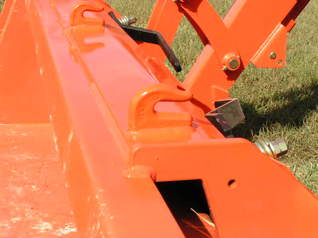

I welded a piece of 2x2x .25 inch angle across the top of my bucket. Makes it much stronger. Especially in combination with my toothbar on the bottom.
Also, I like having a slip hook in the middle and grag hooks on the end. Seems like a slip hook is gentler on a strap or rope than the grab hooks are, and you can still use chain with it if you want too, either by running the chain over to one of the grab hooks, or by hooking it back on itself.
If I were to do it again, I would still use the slip hook in the middle...
