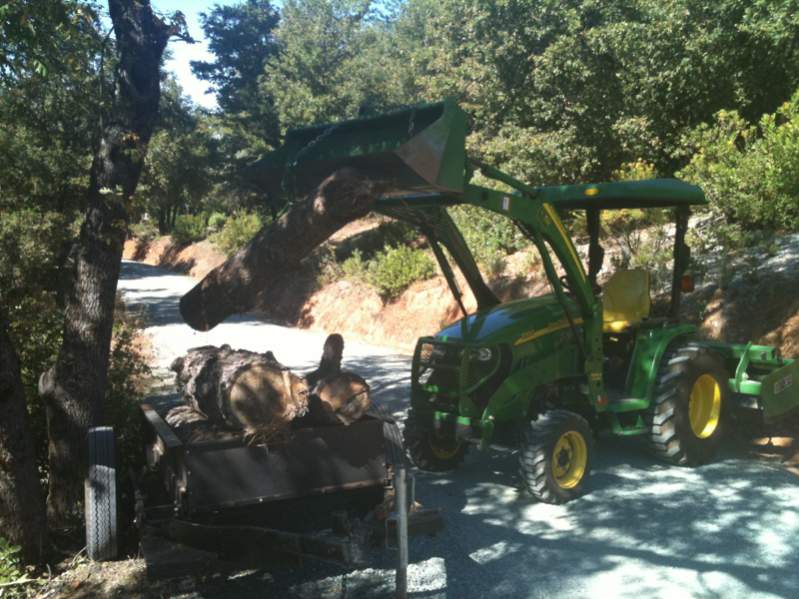

Looks good. I am always finding new uses for my d rings and hooks.

   / Chain hooks and D-rings on my FEL installed #4
We welded hooks on the front bucket. They worked great. We traded the tractor another one (old was shuttle-shift ... new is HST).
First time we needed to lift something we realized just how handy those hooks really were and how much we used them and now miss them.
Will have to weld hooks on the new one :thumbsup:

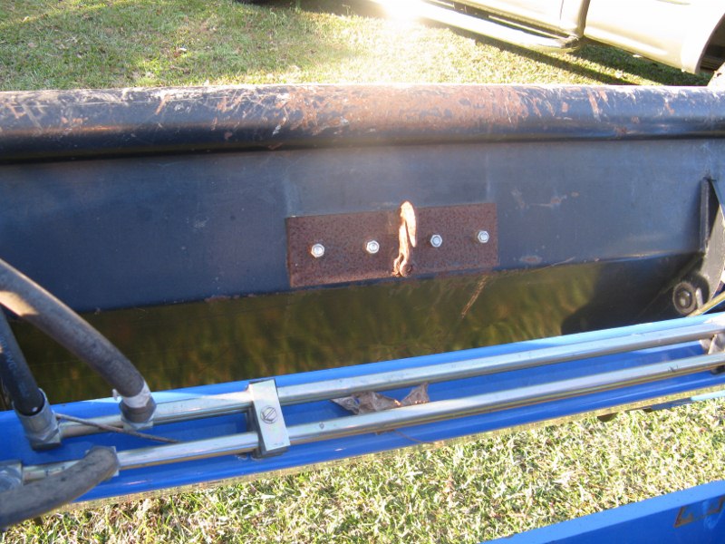

   / Chain hooks and D-rings on my FEL installed #5
My Simple solution. I did not want to weld directly to the bucket. I use a light weight 1/4 inch chain for most of my chores. Lifting anything up to about 500 to 600 pounds. The smaller chain is easy to handle and takes up less space on the floor board of the Tractor.
