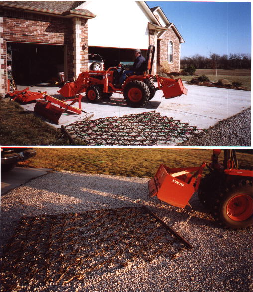

I have mentioned my tine harrow several times. I love the thing--it is very useful and will do nicely for what you mention and other things too. I bought it for my BX orginally and was told 5 hosepower per foot but I dcecided to get the 6 wide foot by 8 foot long and it is just right for the BX and a good size for the 2410 also but you could get the 8 footer. I like the 6 because I can "slalom" in and out and around trees and things easily. Furest flexible tine harrow is what you want--not cheap but very nice quality.
J

   / Chain Harrow? #3
Here is another pic of it behind one of my tractors. J
