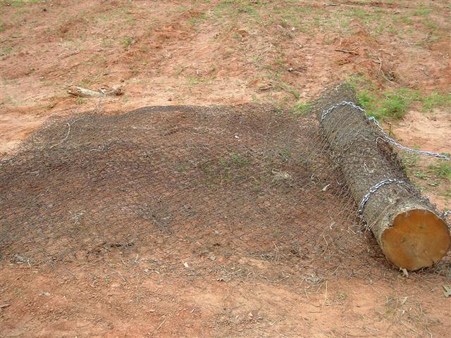

/ Chain Harrow #7
Randy,
I went the cheap route and made my drag from a length of oak and some cyclone fence that I was given. I added a length of chain to pull it and I was done.
One of the thing that I really like about the log drag is how well it moved dirt. It will knock down a high spot and fill in low spots. With a little practice, you can get some amazing results.
The first picture shows mine.
Second pictures shows a litte dirt that's built up after pulling it.
Third picture gives you an idea of what it can do.
The problem I have with those chain harrows is they pretty much just ride over the surface of the soil. You spend allot of money for a tool that only makes a finished grade look pretty. It won't do much to get you a finished grade.
