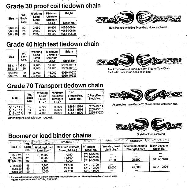

We went to 5/16 transport chains on our semis because of weight of 14 chains and they are almost as strong as 3/8 grade 43.
DOT says;
5/16 transport or grade 7,70 are WLL 4700#
3/8 hi test or grade 4,43 are WLL 5400#
DOT also states that "the aggregate working load limit (WLL)
of the tiedown assemblies used to secure an article against
movement in any direction must be at least 1/2 times the
weight of article ".
Also when buying chains MAKE sure u can see the grade stamps on the links of chain and hooks or DOT WILL rate these at proof coil WLL 5/16 = 1900# and 3/8=2650#.

I thought I would attach a chart with the different chain grades and strengths.
If you can't see it clearly enough, send me an email so I can email you the full image.
