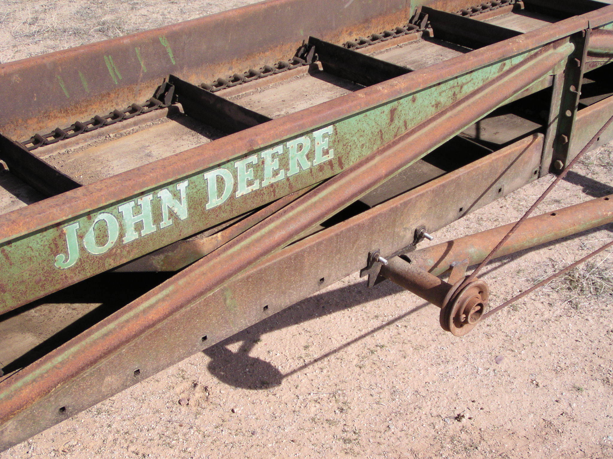

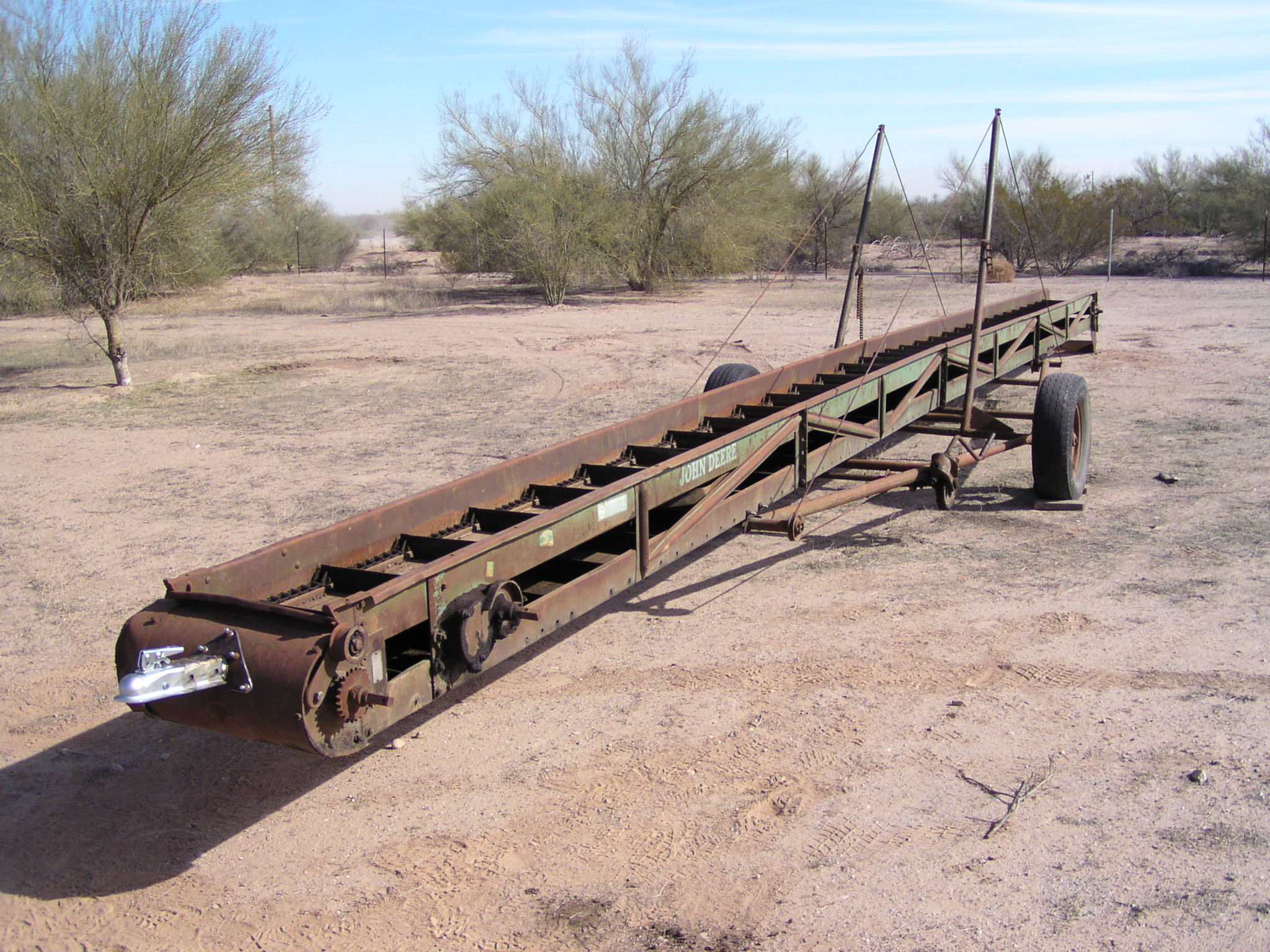

I just bought this 36 foot John Deere hay/grain elevator to do some experiments. The chain on it is good, but I am told that it will break at some point. So I'm looking for replacement chain. Problem is the plate with the model etc. is completely unreadable. I know it's a John Deere because that is printed on the side and I suspect it's an older model because it has cables to lift it rather than solid steel frame members. The closest I could find was a 321? There is an 8088-C embossed in 1/2 inch numbers next to the unreadable plate. Any ideas about this unit would be appreciated. Thanks for anything you can tell me about it, parts, operation, anything. I want to try to use it to move mixed paper - may have to do some creative retrofitting.

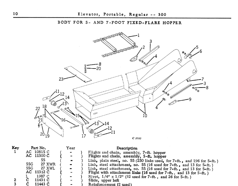

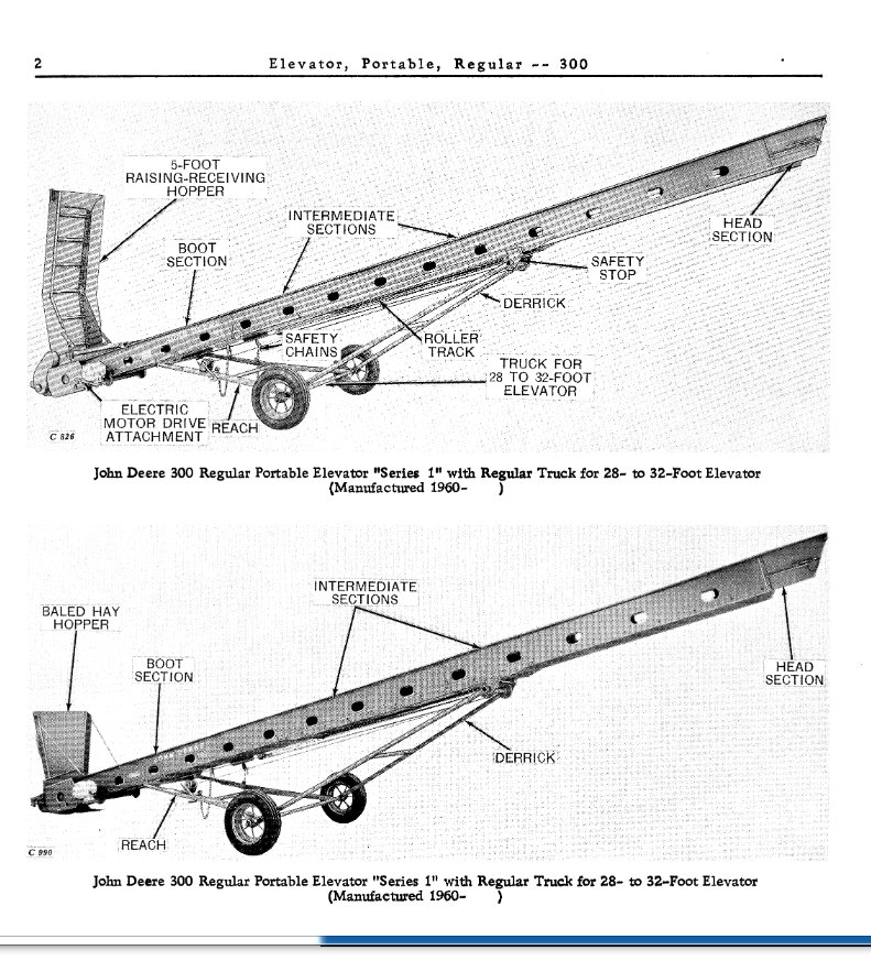

I guessed at the elevator model # as 300 but size of chain should be stamped on chain link if not worn off by use. I came up with chain size of "55". Can you provide me with the correct elevator model #?

There are no numbers on the elevator. There is a nameplate but the information is totally worn off.

I think you figured out the chain type. I just looked closely at the chain in the picture on the right that I attached. It looks like every link has the number "55" stamped in it. Now that we know the chain number, where do I get something like that?
Thanks again for solving the chain puzzle!
