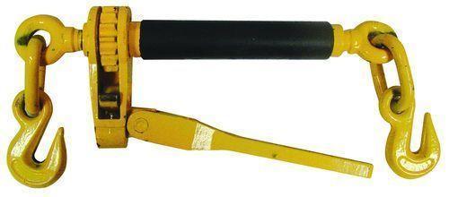

Might be a silly question, but after much searching I'm not really finding it. What weight capacity do I need for a ratchet binder?
I'm towing a Kubota BX23, around 2700#. I picked up some 5/16"-3/8" binders and some 5/16" chain. It all works great, but I was thinking those smaller sized binders out there might be more convenient. The binders I have currently have a WLL of 5400#. The smaller 1/4"-5/16" binders I see out there have a WLL of 2600#. Obviously the WLL doesn't need to match the weight of the load, so what's the rule of thumb for figuring what WLL I should have for the load I'm carrying?

Thanks, that graphic at the end of Chapter 1 I think may be what I need. And if so, sounds like the 2600# WLL binders would be fine to use for my tractor.
