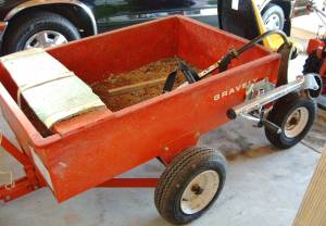

I hitched my cart to my 3 ph drawbar and attached the runaway chain to the drawbar. On the cart, it has a Gravely "Y" hitch. I just attached the chain at the top part of the "Y" with the bottom part of the "Y" going onto the ball on the 3 ph drawbar.
I probably should have done the reverse, e.g. attached ball to drawbar and runaway to 3 ph drawbar, because with a 2 wheel cart, it can go down in back if the load is too much aft. To avoid this, I put an anti-rotation castor to one side of it.

The picture above just shows the anti-rotation castor. Still had my Gravely tractor at that point. You can see it to the right.

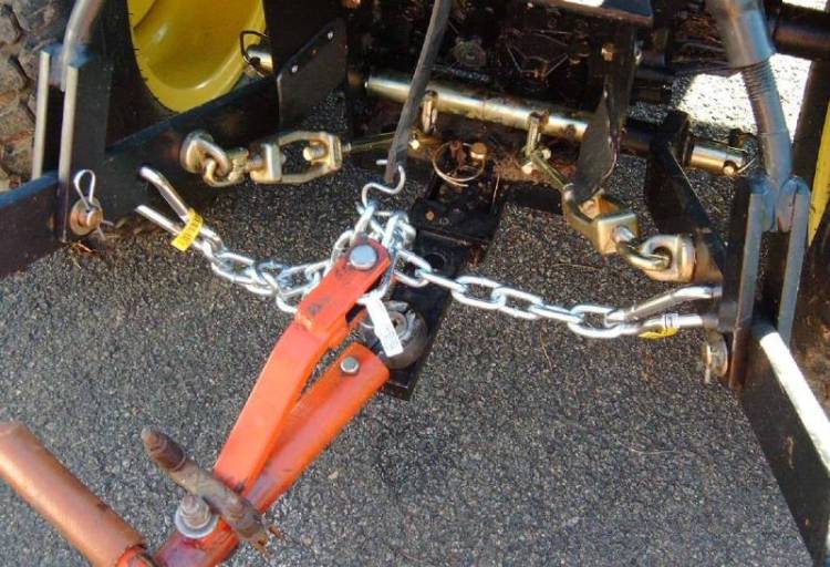

Here's a pic of when I connected the cart to the drawbar, before I had the 3 ph drawbar.
