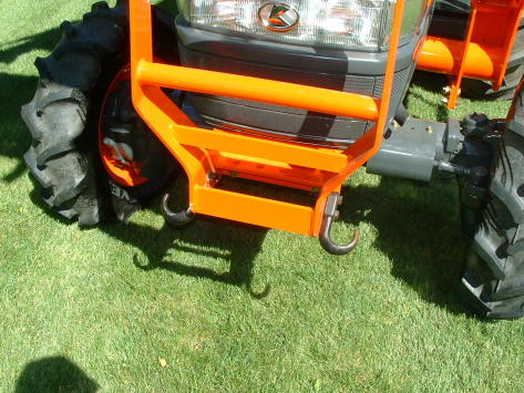

You can wrap the chain around the axle. If you are concerned about the chain scratching up the paint, you can get axle straps at TSC. They are a short nylon webbing that you wrap around the axle and you hook your chain to the ends of the strap.
On my Kubota I bolted hooks on the front to attach the chains to. (see picture)

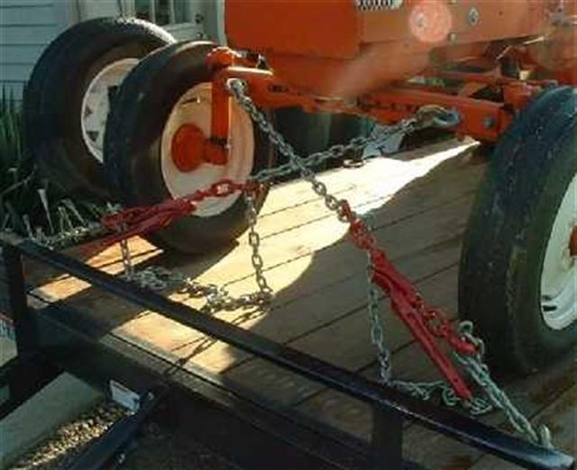

On one of my antique tractors I bolted lifting rings to the front axle to attach my chains to. Many tractors have holes or bolts through the front axle that can be utilized. I will attach a picture.
