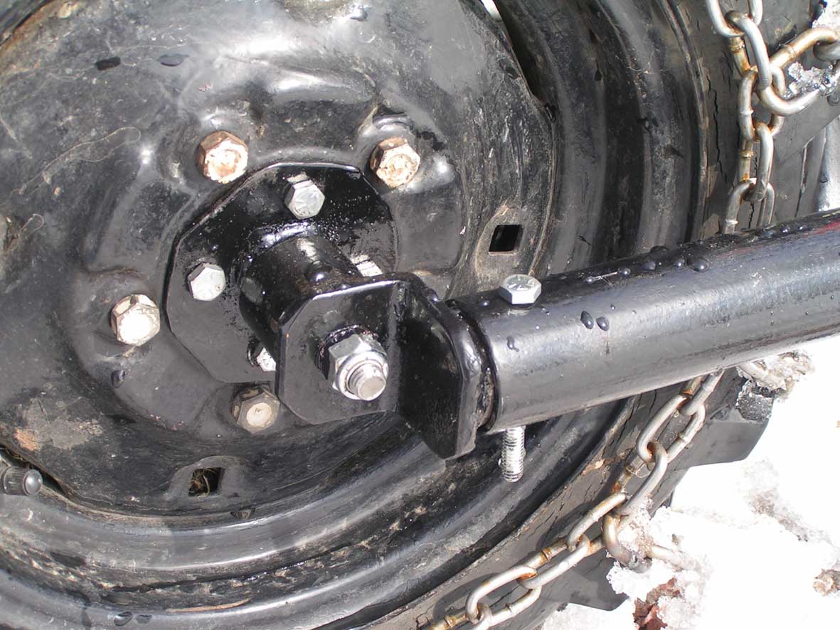

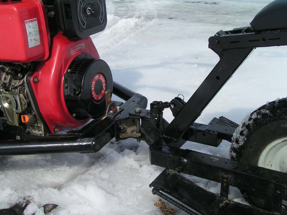

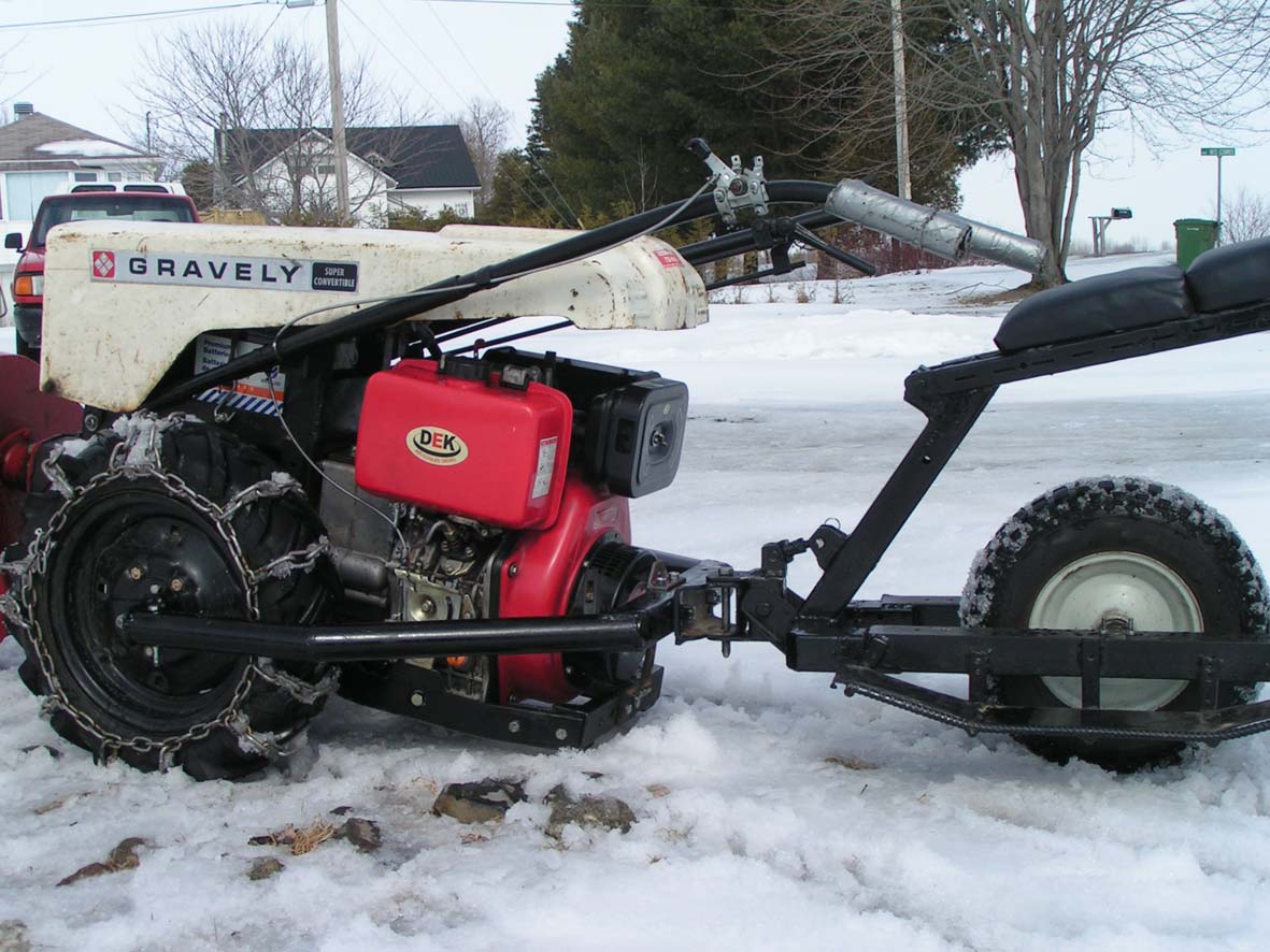

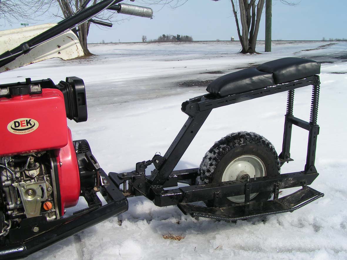

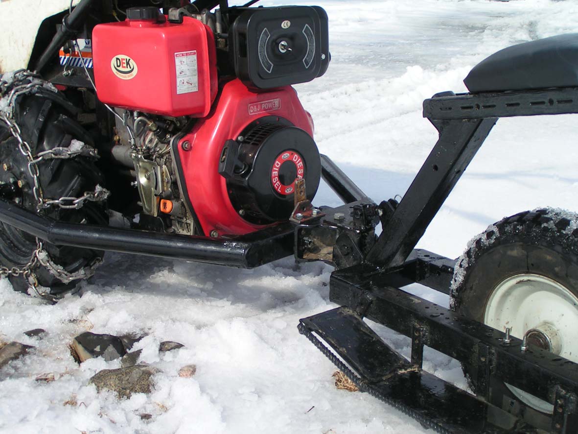

I want thanks Milkman for his BCS sulky pictures on other treads.. I make a Hitch from center wheels. With this way the seat dont Unbalance the tractor and no more Up and down. More confortable. Easy to remove two pins two minutes. Easy to make and inexpensive. Thanks and Good Luck! Oldmech
