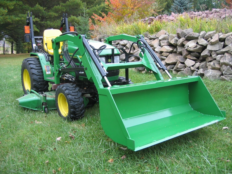

Your the man. I test fitted a cardboard templete. I saw it resting on an old GTO a while back but figured winter will be back and I would have access to a plasma cutter. The summer flew by so quickly and I managed quite a few projects... just not this one. I still think it is a good idea and yours turned out great.
I did get the loader primed and painted
   / Center MMM cover, Did they forget ? #9
WOW :eek: Joe, Nice job on that loader!
