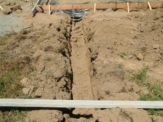

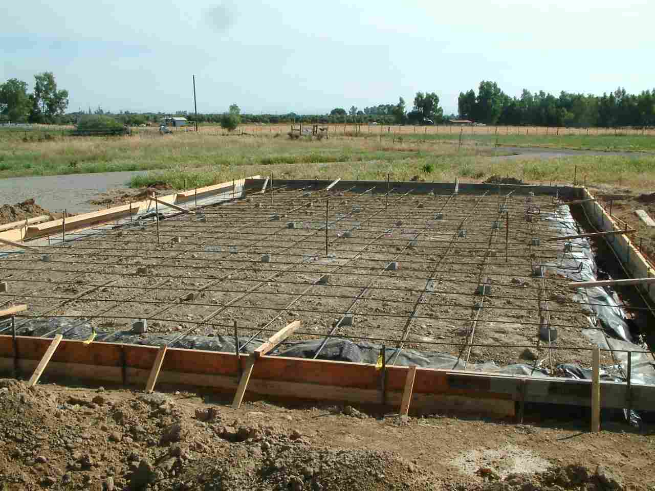

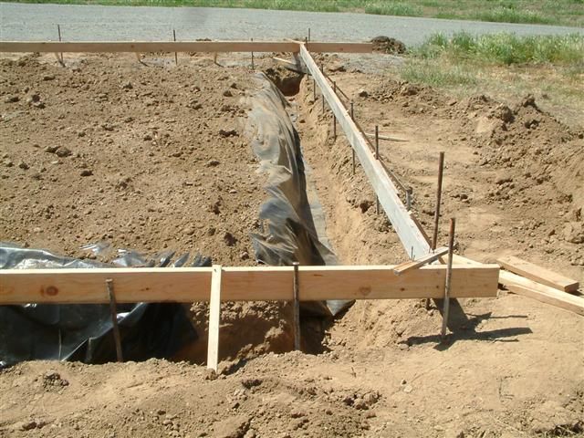

Here's what the site prep looked like when the 24x42 ft slab, 6" thick, 4000 psi concrete, 4" slump was poured for my shop.
This is the trench for the 100 amp 220V service to the shop connecting with the slab footing.

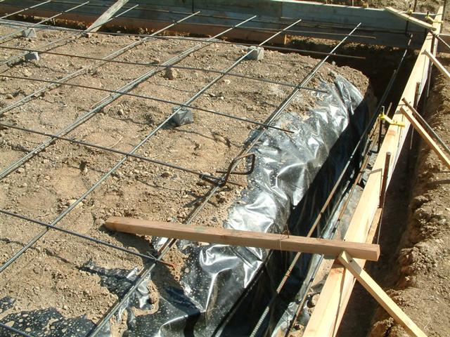

Some images of the site prep work. The footings are nominal 12"W x 12" deep. The black plastic is 6mil Visqueen. The rebar is #4 (1/2") on 24" centers both ways. The rebar under the slab is supported by 3" tall doobies to keep it centered top to bottom in the slab.

You'll need a minimum of 3 guys to do the pour (one on the chute and two with shovels). Then you need the equipment to float the surface and put whatever finish you want (trowel, broom, etc). If you've never done this, then get some experienced help because it's easy to screw up the finish on the slab if you're not careful.
