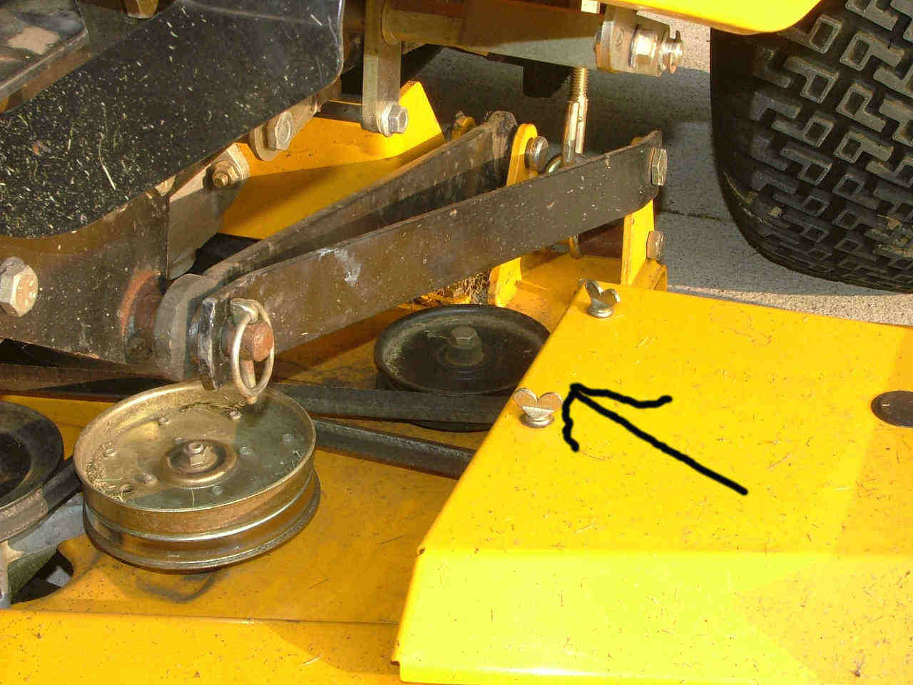

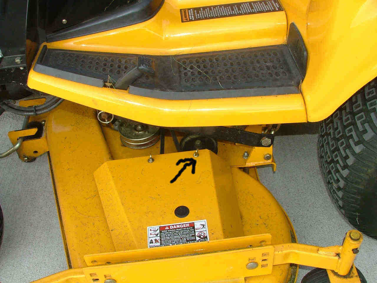

I've had great luck with my 60 belly mower but I have heard about a lot of problems with them throwing belts.
Mine has done that once in three years but it also has an upgrade that added another idler, maybe that's the fix?
If you search though my posts, I put a picture up of the idler I'm referring to.
Curt

Here you go, took me a while to find them.
Curt

First, thanks for the pics, but two questions.
1. Did you install those thumb screws on the cover plates on your deck? If you did, good idea. Wish I had thought about that.
2. I think that may be the wrong side of the deck. The idle pulley arm has the spring that connects to the bolt, and rotates over as tension is put on it. Unless of course they did away with the idle arm, which would make sense since the belts fly off of it regularly. I had a personal fix for it for awhile, I used a spring with less tension, that was longer, it worked for about 14 hours straight. Then the spring broke. At least it wasn't a $10 cub spring.

I can't take credit for the thumbscrews, they were on the deck when I bought it.
I believe all the other components of the deck are the same, but the pulley pictured wasn't on some early 60" decks. It appears to limit the travel on the long run between the outside pulleys.
I'b be happy to pop those covers and take some better pictures if you think that might help.
Just let me know.
Curt
