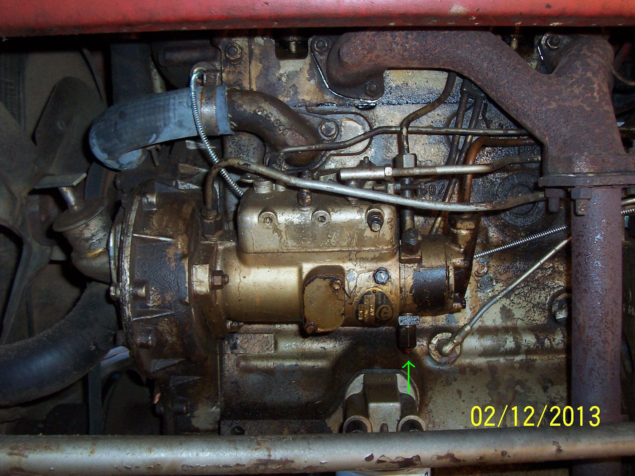

:confused:[SIZE=4]My Massey Ferguson 135 has a leak on the injector pump. It's on the banjo fitting that feeds the # 2 cylinder. I have tightened it as much as I dared but it still drips while running. Any suggestions on how to leak-proof a banjo fitting?[/SIZE]

Try a new copper washer.

G'day those washer are a special steel washer not copper, copper ones do not last any good injector/pump specialist should have them and sell them to you.

copper will work fine

There should be a label on the pump that says what it is. CAV made rotary fuel pumps that were used on many different engines, they were bought out by Lucas and then Delphi.
FWIW, I looked up "mf25 injection pump" and all the rebuilt pumps and rebuild kits that came up were for a CAV.
