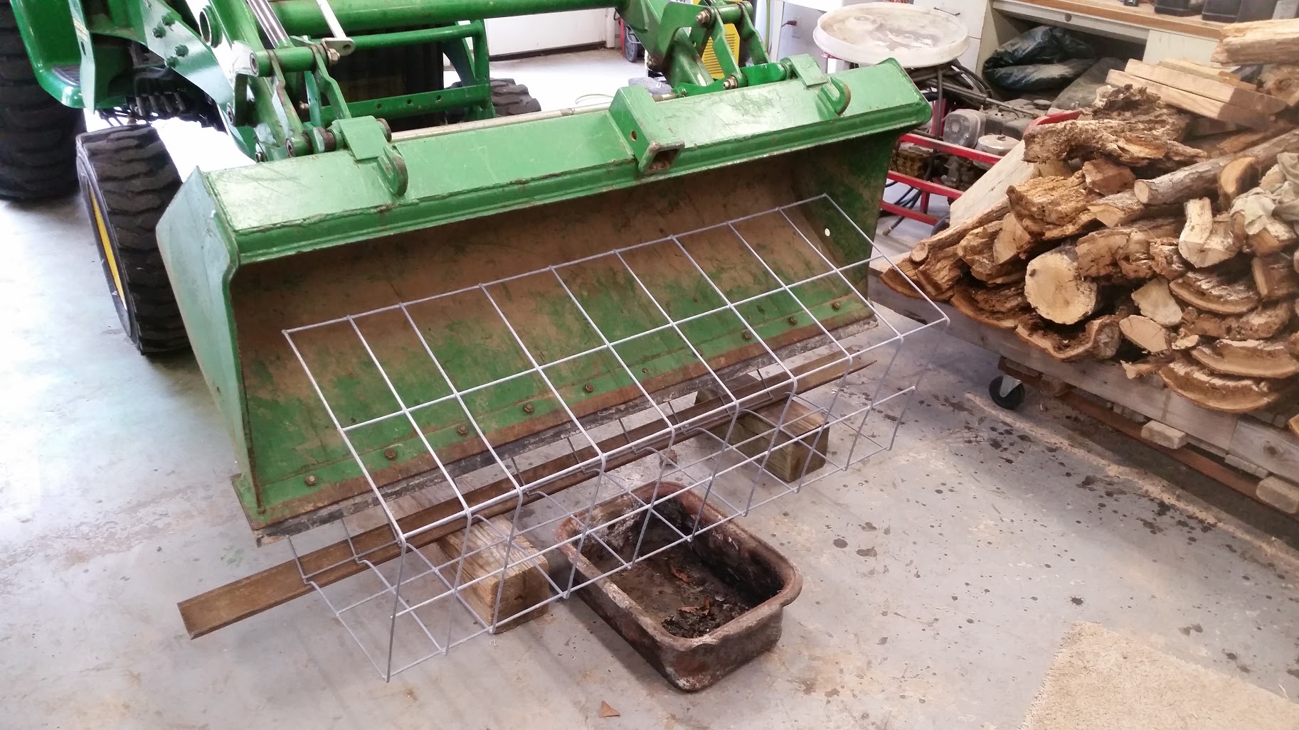

I have 3 4x16' cattle panels to be used for tomato cages. They are to end up being 16" square by 48" tall.
I could cut them up and wire 16"x 48" pieces together to get the job done but I was considering just trying to bend a 64" piece 3 times to make a 16" square cage.
Wiring them together might make storage easier possibly.
I don't have a big torch for heating the metal but have FEL and a log splitter for putting pressure for bending somehow.
I am just wondering if anyone ever bent one to make something. Any ideas welcome. Thanks.

What I learned from bending them, I wouldn't want to make 16" cages. Maybe if you make a jig and a bending lever to sandwich the panel and make a sharper bend. I found that a 2 or 3lb hammer helps correct poor bends. You might be able to bend/hammer/bend/hammer around a square timber to get a nice corner.

I had a few scraps around and cut some and found I could weld them in the shape I want but it is a lot of fooling around. I think I have a big chunk of 5" angle iron laying around and I will set it in there and push down with the FELfor the bend and the finish with the hammering to finish it off. I'll try one bend and see what happens.
