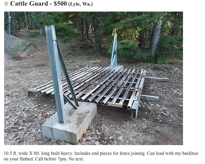

   / cattle guard #5
ive seen them made from using railroad rails here in florida lasts forever
