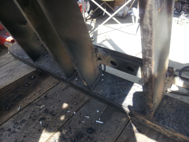

I did something dumb. Yes I am a newb. I have a Shaver HD-10 post driver I bought used. I wasn't aware at the time but they fit Cat II tractors. Mine is Cat I. I can get and modify bushings to make the top link on my 3pt hitch fit. However the pins on the PD for the 3pt lower bars are welded in place. I am trying to think of a way to get my cat I lower bars to fit. I can either; grind the pins on the PD down till the fit the Cat I size n the tractor or get a couple of Cat II lift arm ends and weld them to the Cat I lift arm ends that I have on the tractor or cut the Cat I ends off and weld the Cat II ends on my lower bars and use bushings to use the Cat I implements I have. Is the a simpler solution out there? Which way I mentioned seems to be the best?

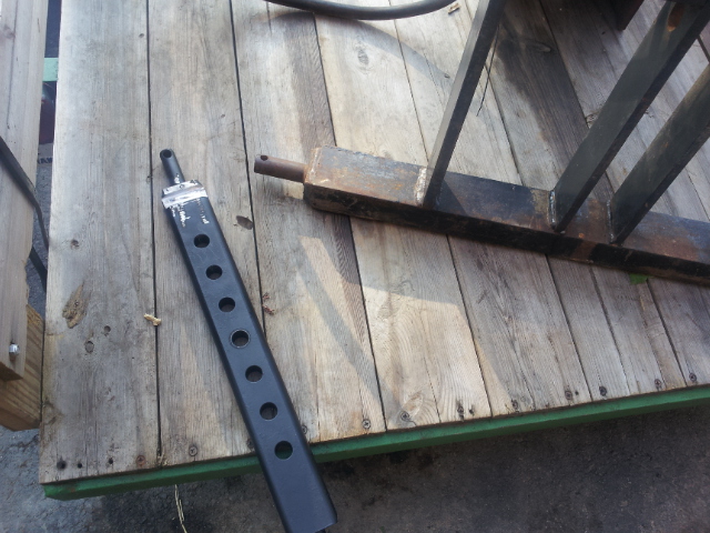

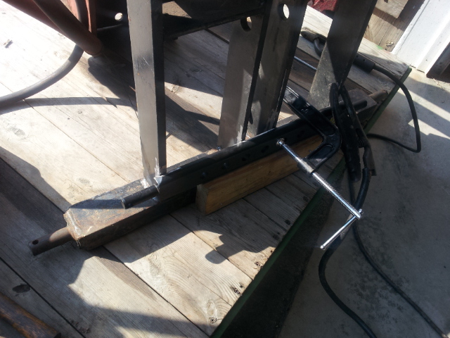

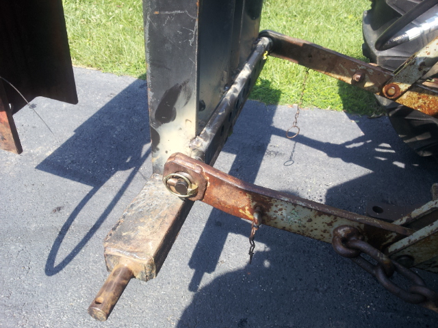

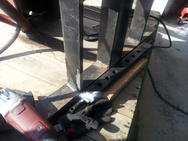

All good suggestions and thanks. I was in TS the other day and walked past the cross drawbars and it hit me. I'll buy one of these and weld it across the front of the PD. Then just use bushings in the top link. Here is the result. Not the prettiest welds but I think they'll hold up. Time will tell after I drive some posts.
   / Category II implement on Category I tractor #6
Just make sure the horizontal drawbar is secure,, hate to see someone hurt if it breaks loose.
