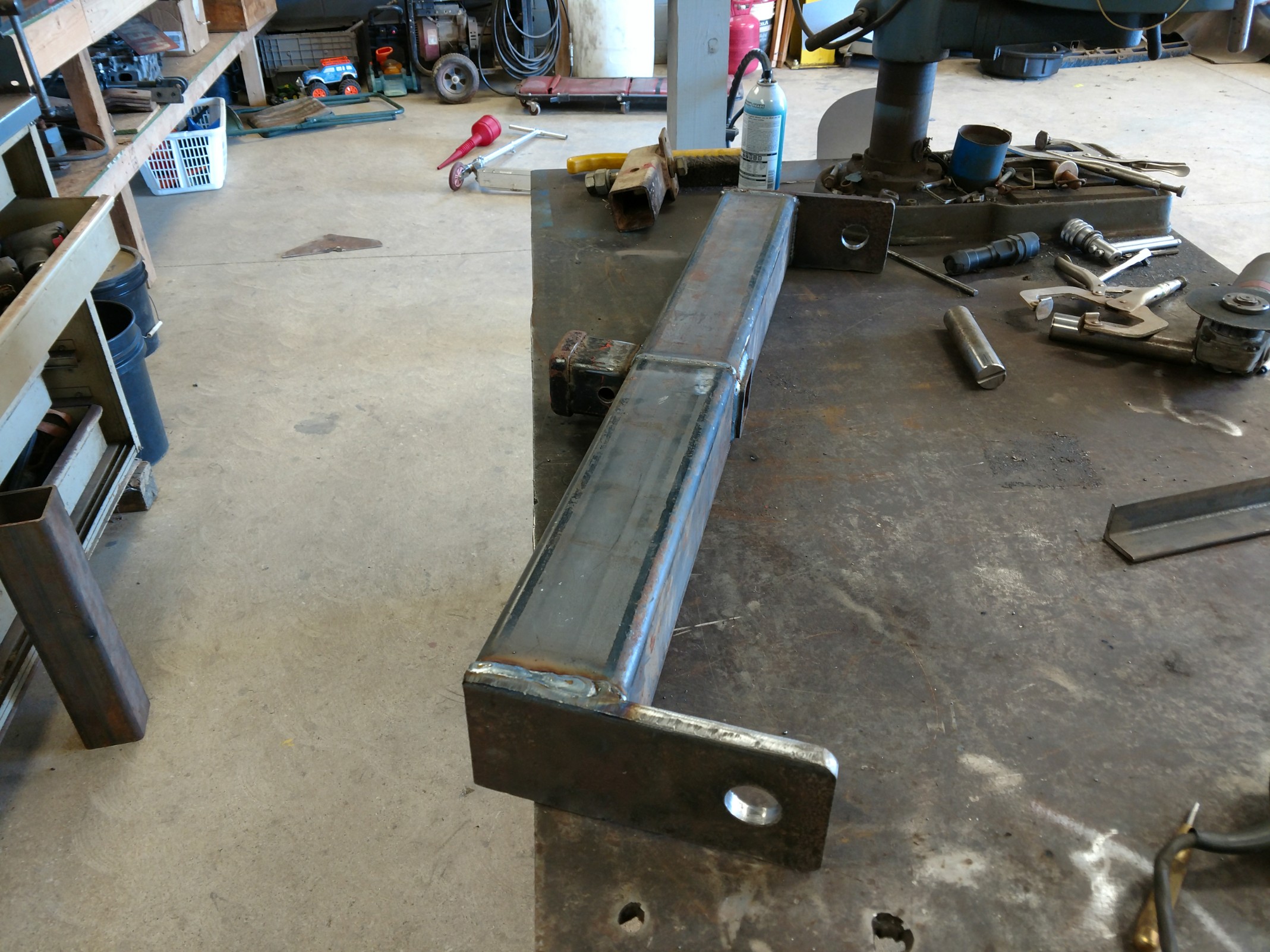

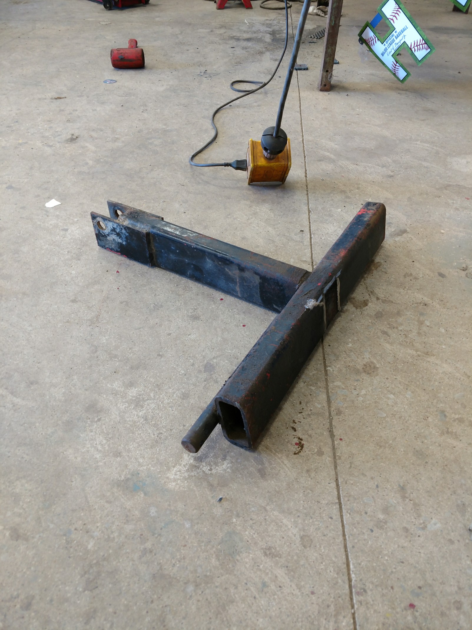

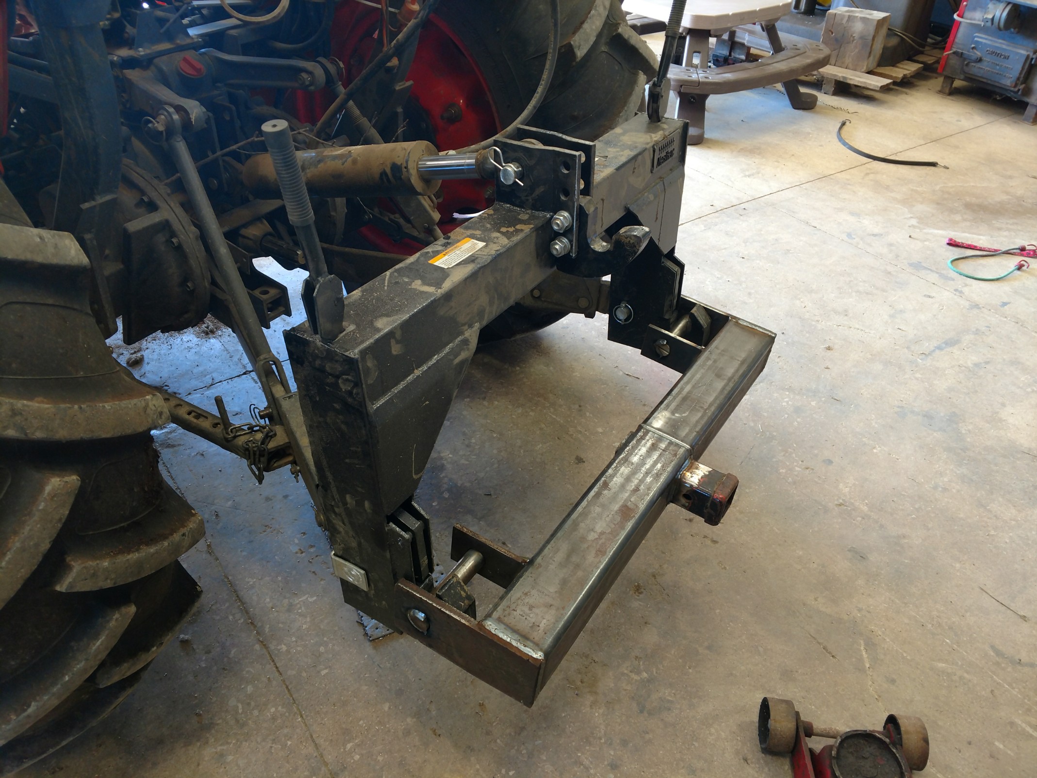

Old trailer mover we threw together years ago wasn't QH compatible.
Didn't like removing the QH Everytime.
So today, starting to make one.
Not sure yet if I am gonna use 1-1/8 removable pins (to use without a QH)....or if I'm just gonna weld some clevis style pins on solid. And can go as big as 1-1/2" and still work with my qh......decisions decisions...
   / Cat II quick-hitch compatible trailer mover
#2

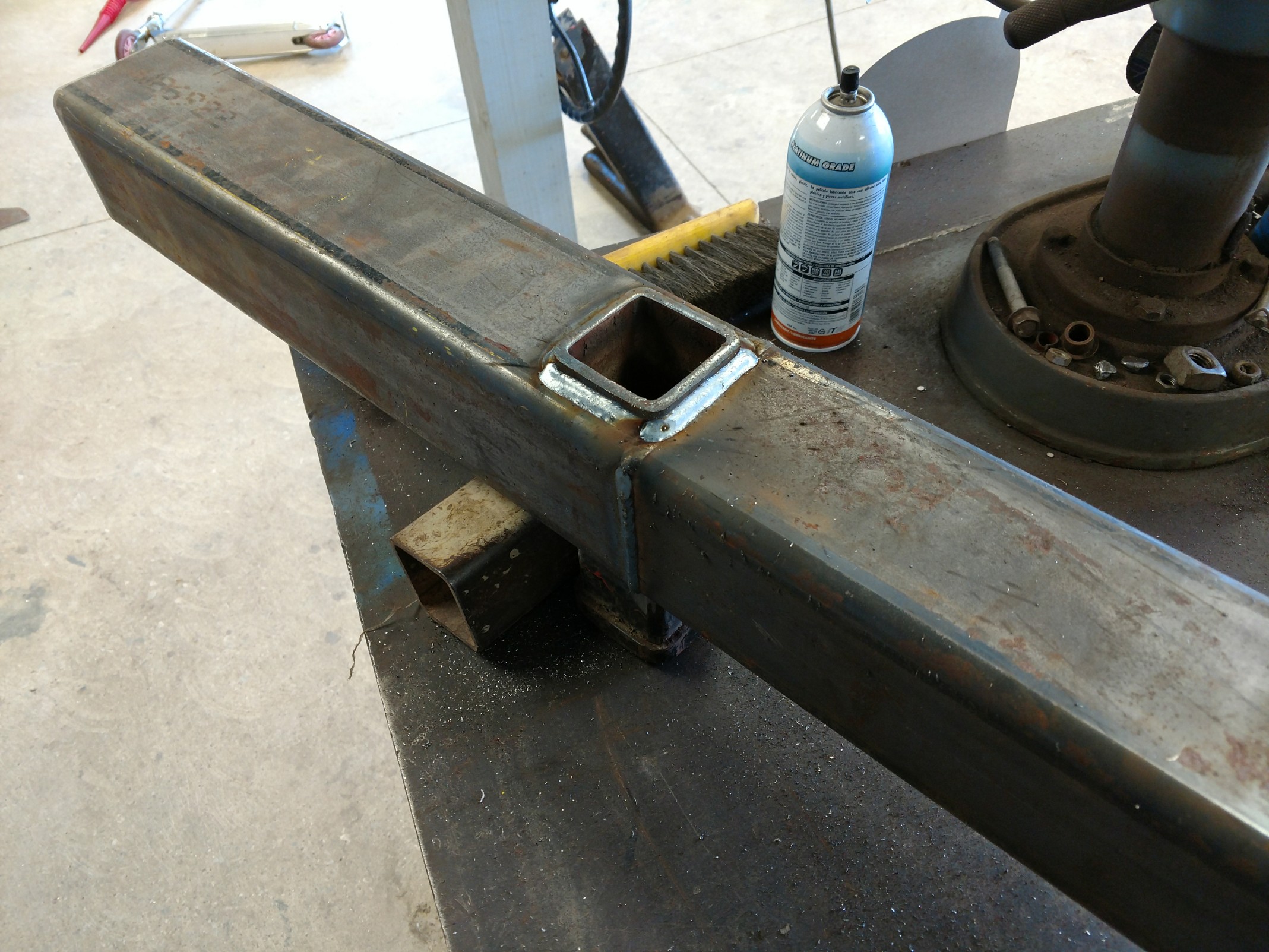

Got the old 2-1/2" tube insert receiver cut off the old hitch and welded on.

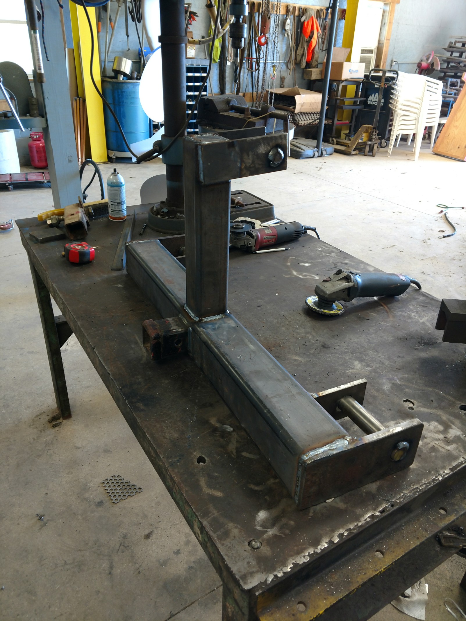

Ends on. 1/2" thick

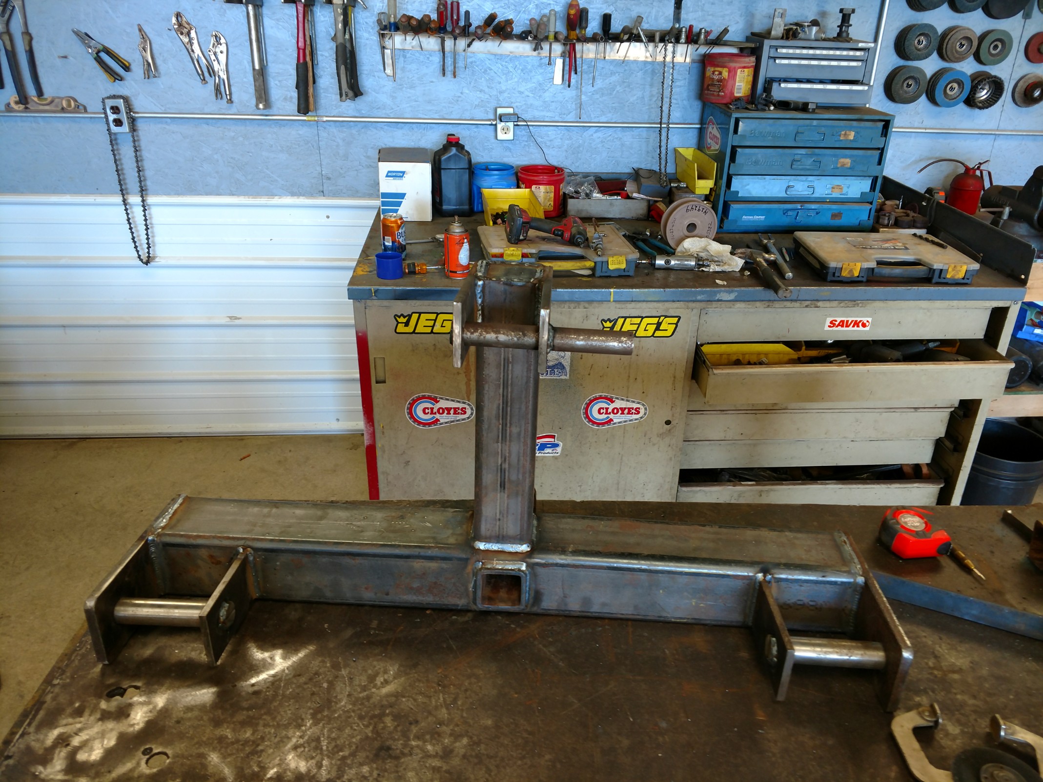

Top link part is all that's left

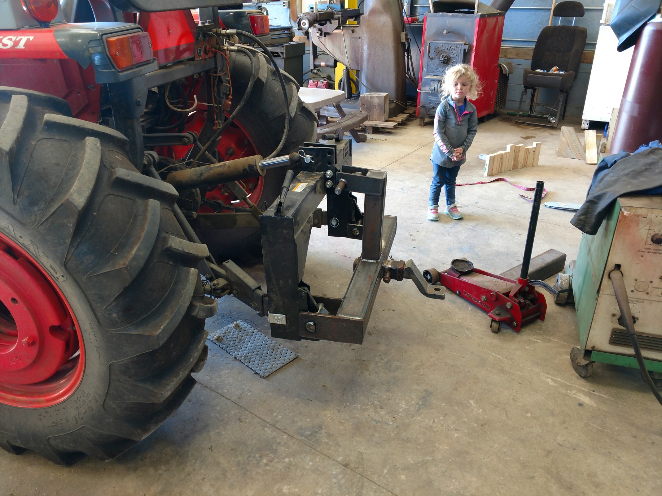

Done. Need to paint
