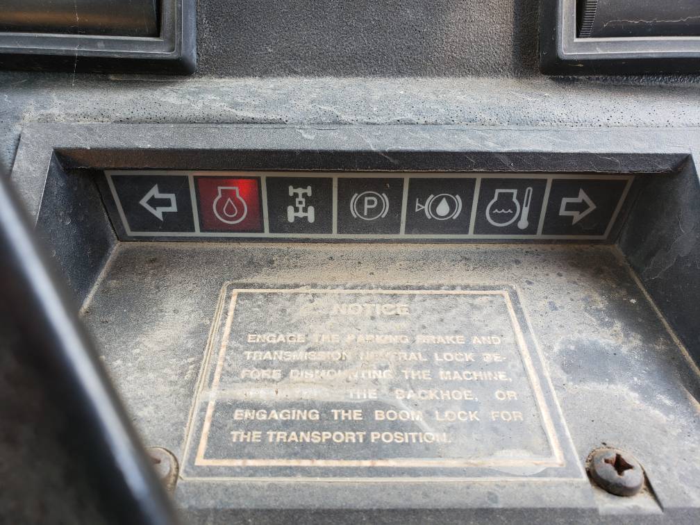

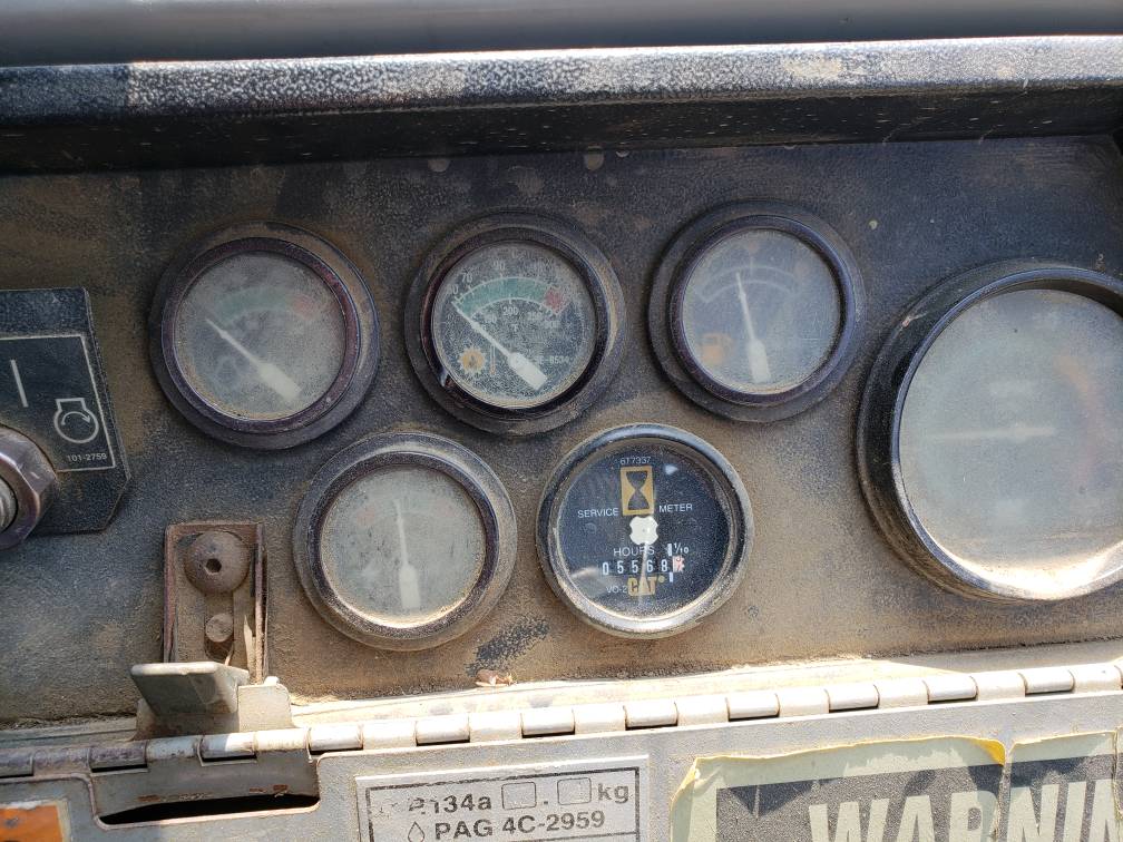

I have a 1993 426B backhoe that has been over heating lately. It was taken into the shop for some hydraulic work and ever since it's been over heating (I'm not insinuating they did anything, just stating that it started after). Anyways I replaced the thermostat which the old one looked good. I'm hoping the picture can give some insight. The heat gauges dont move and when the key is placed to the accessory position not all the lights turn on like they use to. The light that use to turn on was the second from the right. Any help would be appreciated. Thanks! 20180618_153448.jpeg20180618_153442.jpeg

I'd get the guage working first. Have you checked the sending unit and wires yet? I attached a quick check method. How do you know it's overheating, just because the buzzer is sounding?

That's my next step. I'm just going to replace them as they're the original and they're not that expensive
