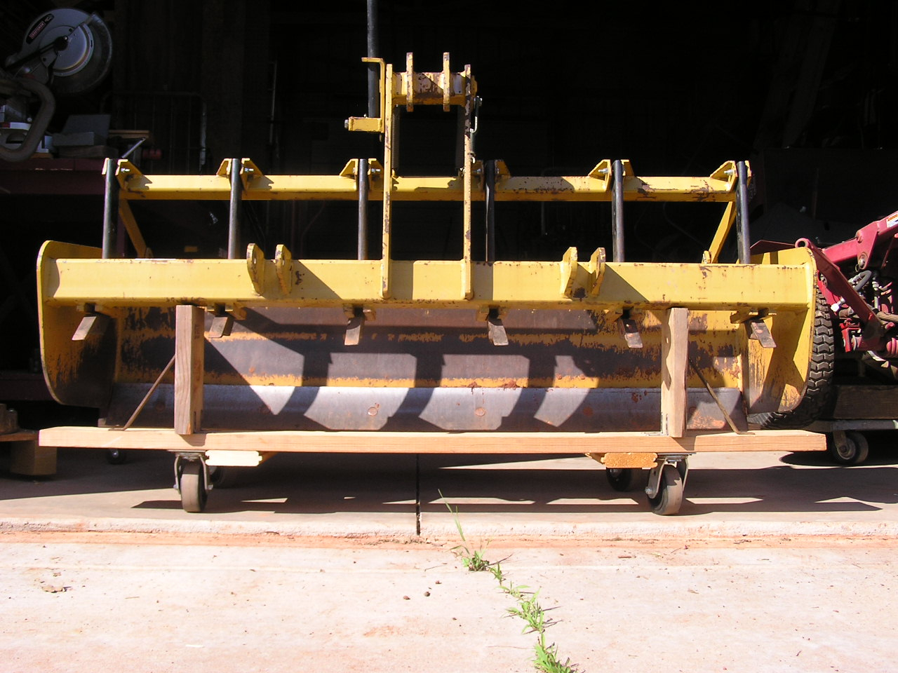

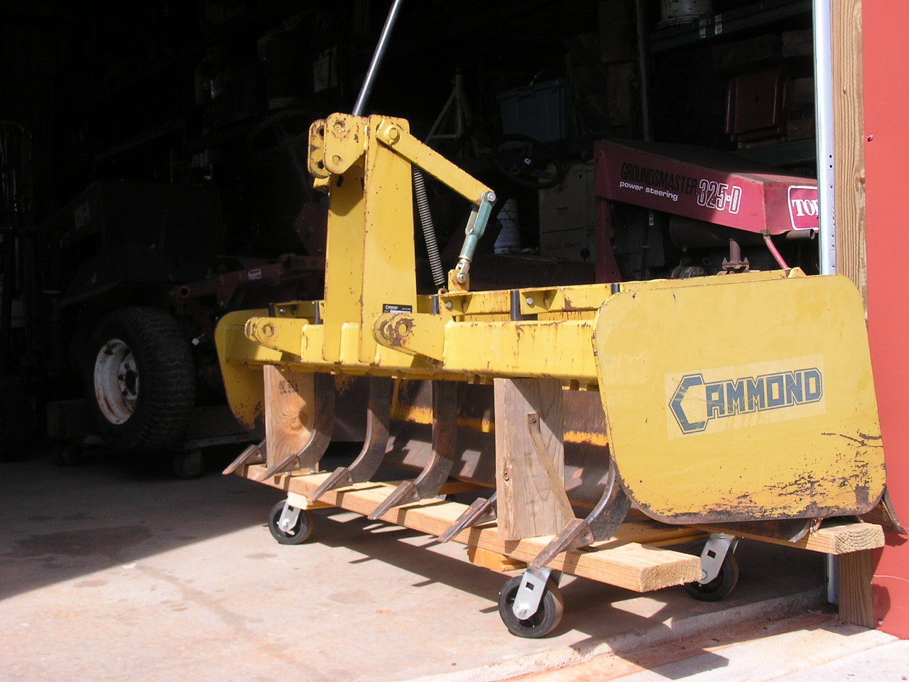

If I'm reading this right the implement uses the clevis with pin meaning you need a smaller pin with spacers where it goes through the clevis mounts?
If so most likely it was cat 2/1 implement that doesn't use separate mounts. My box blade is made that way, its set up for cat.1 but has removable bushings pressed into the clevis mount to allow cat 2 pins to be used. The spacing is cat 1 with extra area in the clevis to get closer to cat 2 width if need be.
