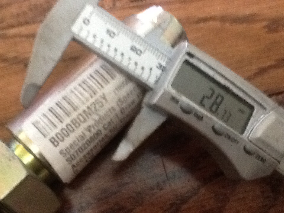

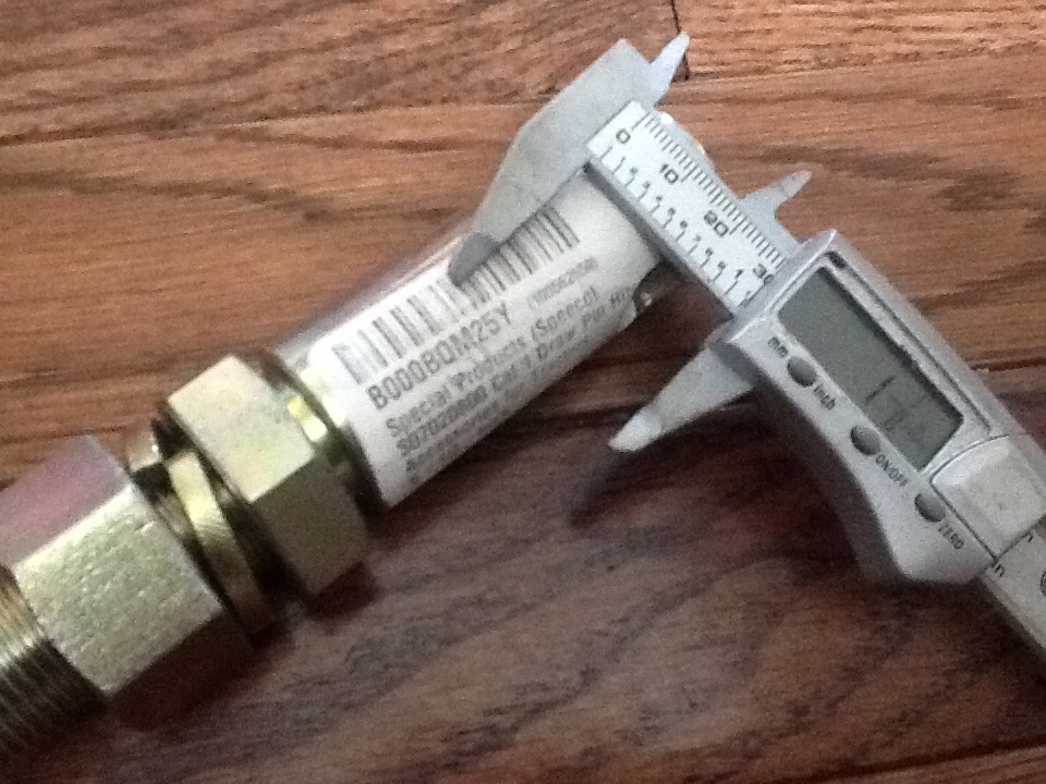

Cat 1 lift pins... Should be 7/8" Diameter?

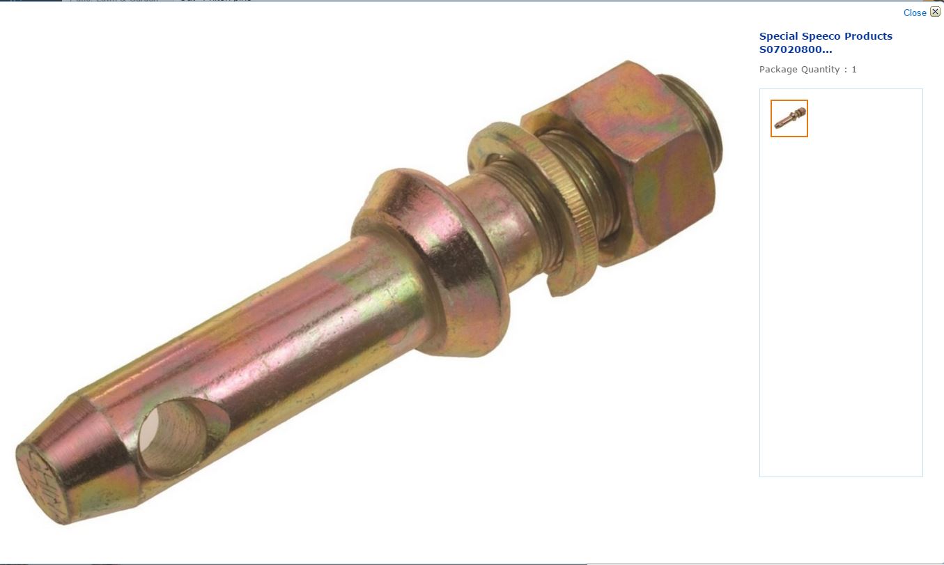

I just got these "cat 1" pins that are 1 1/8" with 7/8 thread delivered from amazon.
   / Cat 1 lift pins #2
Those are cat 1 to cat 2 lift pins. Used for fitting category 1 implements to a category 2 hitch.
   / Cat 1 lift pins #3
Wait, your calipers reads fractions? :p
   / Cat 1 lift pins #5
Yep, you got cat 2 pins, even though it says Cat 1 in the ad. :thumbdown:
